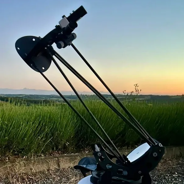

Before you fire up the 3D printer, be aware that PLA is not recommended, and, of course, you are going to need some extra parts. There is supposed to be a README with a bill of parts, but we didn’t see it. However, there is a support page in French and a Discord server, so we have no doubt it can be found.
It is possible to steal the optics from another telescope or, of course, buy new. You probably don’t want to grind your own mirrors, although good on you if you do! You can even buy the entire kit if you don’t want to print it and gather all the parts yourself.

  1. …So not PLA, what’s the suggested material? ABS? PETG? Some stupid exotic filament?
    Looked through a couple linked pages, one translated from French, and no real mention of what WAS used to print this.
    What’s the issue with PLA? I assume heat warping. That should only be an issue in certain specific areas.
    1. it says ABS ASA PETG in the readme
      i’d like to know why they recommend against PLA. my personal feeling is that PLA’s no good for durable goods, because it becomes so brittle. and this does seem to require a thin part holding the secondary up, which will actually certainly fail in a small number of years. but i imagine they have different concerns.
      1. Almost certainly moisture and form creepage under load, it’s just not great for functional parts that need to keep their shape to any great degree like this would need.
        1. Yeah I figured this was most of it. Any amount of creep in the sockets for the struts holding the mirrors would immediately ruin collimation and all sorts of other things.
      2. PLA is not all that rigid, and rigidity is everything in a telescope. Orientation with respect to gravity would significantly distort the truss in noticeable ways. The recommended filaments form much more rigid structures once they cool.
          1. Why not print PLA parts, add a wax sprue, slather on plaster, then burn out the PLA. Last step, use this as a mold to cast an aluminum part from scrap soda cans
          2. But PLA sags under the weight with time, unlike other mentioned filaments. You will have to readjust everything after a week, after a month telescope will go to trash, I have unfortunate experience with PLA and telescopes…
        1. Ummm, PLA is more rigid than some of the recommended filaments. So it’s not that. PLA isn’t as tough as the others mentioned and isn’t as durable so that may be part of the issue.
    2. I’ve been 3D printing stuff for about 12 years. In that time I have printed no more than 2 kg of PLA filament. Once I realized that PLA prints won’t hold their shape if you leave them in a hot car for a few minutes, I stopped using PLA.

      1. Fully agree with you. PLA is overrated; PETG gets a bad rap for being goofy, but in my experience modern PETG is just as easy to print. It also has the advantage of being really easy to sand

      2. Don’t use PLA ever? Um, no. That’s very poor advice. It’s cheap, ubiquitous, versatile, and ideal for many applications. It’s not perfect for some projects, so yes, use another material in those cases.
      3. I also had the hot car moment. I stopped printing stuff that would matter in heat with PLA, but plenty of things stayed PLA if they were not dimensionally important, or would live 100% of the time in air conditioning. It’s all about the application.
        A telescope will be in a hot car, it will get hot from focused light (even moonlight will heat up a telescope by a surprising degree!) and it will go through all other sorts of stresses… So I agree on the no PLA, but I was frustrated by the statement of a negative without any positive suggestion :)
  2. the focuser is interesting. if i was inclined in this direction i might print the focuser and maybe even a couple brackets but i would definitely be drawn to more traditional assembly techniques for the rest of it. but it seems like there’s a lot of people out there who don’t mind running 2kg of filament through their printer for a single project.
    fwiw this seems to use a 150mm f/5 mirror, which is what i have in my favorite scope. i think it’s a great size, big enough but not too big. compatible with wide views but still easy to get a lot of magnification. orion used to sell a good dob in this size as the “starblast 6” for about $300, which doesn’t seem like much more than you’d pay to put together this kit (mirror alone seems to be $130). i’m not going to put much effort into the search but last time i looked around i was surprised to see no one seems to be making a telescope like that at the moment…kind of a bummer given that chinese manufacturers have made the price come down for a lot of quality optics, but this size seems to be abandoned. one of the rare cases where a bit of kit actually became less common / affordable?? maybe i just looked wrong.

      unless the spider vanes holding the secondary are a lot thicker than they look then i would be really worried about that part in particular becoming brittle over time. i’d be paranoid about it breaking off and falling onto the primary. but you’re probably gentle with your scope..
      what are you using for a focuser? the 3d printed helical (screw thread) focuser seems really frustrating to me (i’ve used a factory-made one of those before), but depending on the eyepieces you use maybe it isn’t so bad? seems like probably the thing i’d experiment the most with if i built one
      1. I also made the Hadley after seeing it here, it was my first telescope and has been absolutely brilliant.
        It’s been to outreach sessions multiple times and so far the only damage was when I left it in my car and the altitude bearings melted! This was unexpected being in the UK but it taught me a lot about PLA. Surprisingly the spider vanes which are only 2 wall thicknesses (the alternative curved spider) has never had any issues but I can understand why PLA isn’t recommended for something you might leave in a car or travel with.
        For Hadley I swapped to the Hypatia crayford focuser and don’t think I’ll ever change it, so easy to use but does require a few specific parts to buy and make aside from 3d printing. The stock one I found difficult to get to the right tolerance but there have been a couple of revisions now so might be better. I might have a go at printing the focuser from this telescope too as it looks really neat.
        I got a Bambu A1 mini last year which was a huge speed and experience upgrade over my old DIY prusa but I might have to resurrect that to print this!
      2. I thoroughly recommend building one (a Hadley). It really works, and it’s not expensive. And yes, it is fun. I haven’t had any of the problems you are concerned about, but the key point is that I could re-print any parts that degraded.
        The main advantage of this design is that it’s Open Source. So, all of the dimensions are available, and new parts can be designed that fit perfectly with the others. I started with the stock eyepiece/focuser, but it’s not that good, so I moved on to an improved version (although I can’t remember the name).
        My advice for anyone who is curious is to go right ahead and build one. The Moon looks fantastic, and I have seen Mars and Jupiter (and four moons) and some well-known star clusters. It’s just amazing, and I built it myself.
  3. Hello, I’m Raph, the creator of the Smallest. Thank you very much for sharing the project, it’s really cool. I have modified the accessibility of the Readme file to make it straightforward.
    You will want to hike or go to darker places with your compact telescope, but PLA will deform if left in a moderately hot car.
    1. Thanks for dropping in! And thanks for clarifying the reason for “no PLA”. I think you should add this to the description on the website. When anyone makes such blanket statements without any context or explanation others start to get suspicious, and want to know why. I suggest “DO NOT print with PLA – it will deform if you leave the telescope in a hot car”. Then it’s up to others to heed the warning, or not, but for the right reasons.
      I printed my Hadley with PLA. I am careful not to leave it in a hot car, or other excessively hot environment. I haven’t noticed any creep, but it’s fully adjustable, so it can be realigned at any time. It’s certainly not going to change shape over a few hours.
