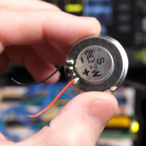

When [Ben Eater] talks, hackers everywhere listen. In his latest video [Ben] shows us how to make computer noises using square waves and a 6502 microprocessor.
[Ben] uses the timer in the W65C22 Versatile Interface Adapter to generate the square waves which generate a tone. He then adds support for a new BEEP command into his MS BASIC interpreter. We covered [Ben Eater]’s MS BASIC here at Hackaday back in April, so definitely check that out if you missed it.
After checking the frequency of oscillation using his Keysight oscilloscope he then wires in an 8Ω 2W speaker via a LM386 audio amplifier. We can’t use the W65C22 output pin directly because that can only output a few milliwatts of power. [Ben] implements the typical circuit application from the LM386 datasheet to drive the speaker. To complete his video [Ben] writes a program for his BASIC interpreter which plays a tune.

  2. friends don’t let friends use the LM386. Though I suppose it is period appropriate for a 6502. Still, if you’re just using square waves, why not a simple transistor?
