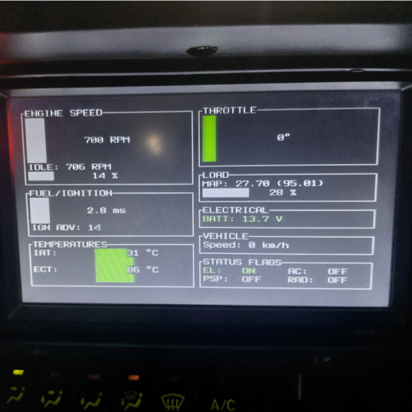

The project started with Python-based scanner code designed to decode Suzuki’s SDL protocol. Armed with the ability to read the protocol, [Shehriyar] wanted to be able to do so without having to haul a laptop around in the car. Thus, the project was ported to Rust, or “oxidized” if you will.
More after the break…
[Shehriyar] has installed the system in a Suzuki Baleno. The Raspberry Pi uses a VAG KKL interface to connect to the car via its OBD port and connect to the SDL line. It decodes this data, and processes it to pull out parameters like speed, RPM. It then drives an LCD display on the double-DIN stereo in the dash. A simple composite output allows the system to display live data while driving the vehicle. The UI uses the Ratatui library. The result is a display that both updates smoothly and rapidly. It has a great retro vibe that kind of reminds us of some interfaces seen in Hollywood movies. Despite being analog video, the results are pretty sharp.

    1. Hi, I’m the author of the tool.
      I get the concern. The stereo is number one (from the bottom). The camera does injustice to the actual brightness since turning on parking/tail lights dims the display, so it’s not “that” bad at night.
      I had swapped out the previous “better” android head unit for this cheap stereo as the brightness of android one was too much for me (maybe due to the bigger size as well). This is way better in terms of low brightness even though the quality is crap.
      That was the point of decoding SDL. The engine is Suzuki’s G13BB w/o O2, which came ~1995. There were two variants, one with and other without oxygen sensor. Mine’s w/o O2 sensor and suzuki only provided SDL to get all data (immobilizer + engine data).
      For O2 equipped engine they provide 2 lines, a normal K-line (9141-2) (OBD2) (for engine data) and SDL is also there but mostly just for interfacing with immobilizer.
