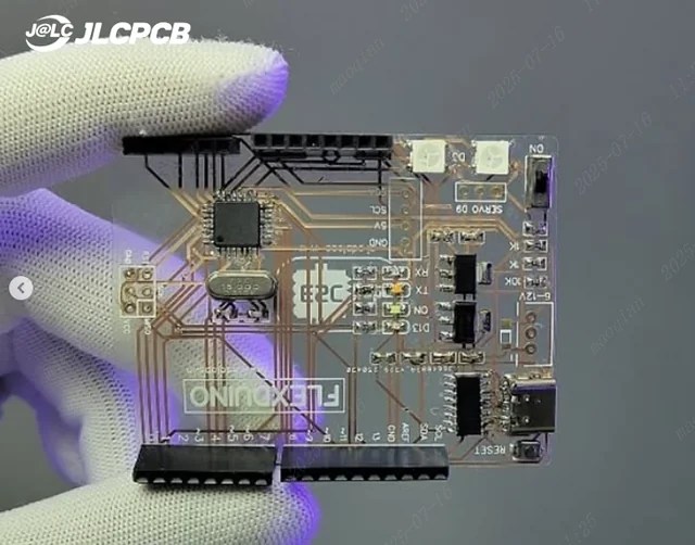

What color do you like your microcontroller boards? Blue? Red? Maybe white or black? Sadly, all of those are about to look old hat. Why? Well, as shared by [JLCPCB], this transparent Arduino looks amazing.
The board house produced this marvel using its transparent flexible printed circuit (FPC) material. Basically, the stuff they use for ribbon cables and flex PCBs, just made slightly differently to be see-through instead of vaguely brown.

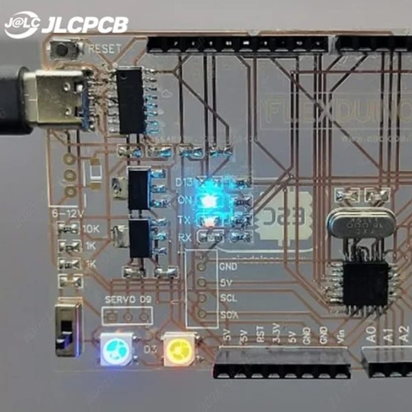

The circuit in question is a Flexduino, an Arduino clone specifically designed to work on flexible substrates. It looks particularly good on this transparent material, with the LEDs glowing and the white silkscreen for contrast. If you like what you see, you can order your own circuits using this material directly from JLCPCB’s regular old order form.

Wait, is it possible to make vias and microvias in this substrate?
Is the ground plane some kind of transparent metal as well?

Without a ground plane, the designer would need a lot of luck getting it through EMC qualification, unless it not for sale on the market. And abysmal soldering, but held in white gloves as if it’s some high tech process. But as it’s JLPCB, you get what you pay for. Not that I’m whinging, but it doesn’t look well built at all and not an advert for their work. Today processors require a good ground plane, not only for decoupling which will help with qualification, but that crystal may become susectable to failure even after startup. Although for some applications a clear PCB would be excellent idea especially for use with membrane keyboards with back light buttons using ‘bottom entry’ LEDs (they emit light towards the PCB and need a hole in the PCB to let the light though without attenuating it’s brightness).
This really just seems like a one off proof of concept for the tech. Lacking the ground plane makes sense if they’re trying to show off the transparency rather than create an Arduino clone to sell.
