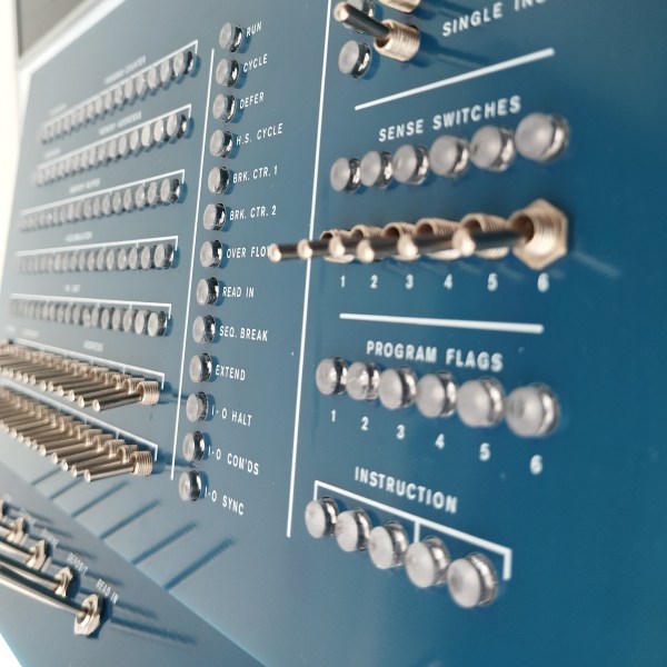

Over on Hackaday.io our hackers [Angelo] and [Oscarv] are making a replica of the PDP-1. That is interesting in and of itself but the particularly remarkable feature of this project is its novel use of printed circuit boards for casing and instrument panels.
What does that mean in practice? It means creating a KiCad file with a PCB for each side of the case/panel. These pieces can then be ordered from a board house and assembled. In the video below the break you will see an example of putting such a case together. They use sticky tape for scaffolding and then finish things off by soldering the solder joints on each edge together.

  2. I’ve thought about this a few times, but I assumed that every board house (JLCPCB is my preferred one) would be dinging you for each individual “sub-design” as if it were its own PCB. Is that not the case?
  3. I’m making panels from aluminum PCB’s. Since I’m familiar with kicad for designing them and JLC produces them very cheap.
    Routing and dril holes are perfect and so is the white coated surface finish. The black silkscreen printing is s little low resolution but nothing that bothered me.
