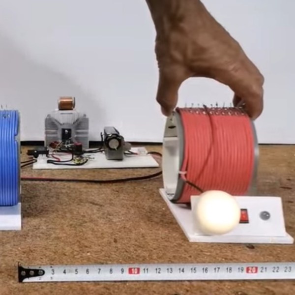

A photo of a the power supply, distribution board, and primary and secondary windings on a bench top.
[mircemk] has been working on wireless power transmission. Using a Class-E Tesla coil with 12 turns on the primary and 8 turns on the secondary and a 12 volt input he can send a few milliwatts to power an LED over a distance of more than 40 centimeters or power a 10 watt bulb over a distance of about 10 centimeters. With the DC input set at 24 volts the apparatus can deliver 5 watts over a distance of a few centimeters and a light is still visible after separating the primary and secondary coils by more than 30 centimeters.

  1. Besides the air-cap, I don’t see any filter elements. That thing’s gotta be loud. I wonder how many orders of harmonics it puts out.
    1. It’s pretty much a spark gap transmitter. And illegal.
      Not to mention the clulessness of the article author. Nobody cares about the voltage. It’s the power delivered to the primary vs the secondary that matters.
      Kudos to the builder. Class E is fun. I’ve built a 500 watt rf deck on 10 meters class e, amongst other high power class e peojects.
