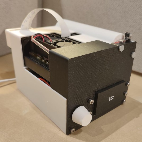

A black and white device sits on a beige table. A white rotary knob projects out near the base of it's rectangular shape nearest the camera. Near it is a black rectangular section of the enclosure with six white dots protruding through holes to form a braille display. A ribbon cable snakes out of the top of the enclosure and over the furthest edge of the device, presumably connecting to a camera on the other side of the device.
One of the practical upsides of improved computer vision systems and machine learning has been the ability of computers to translate text from one language or format to another. [Jchen] used this to develop Braille Vision which can turn inaccessible text into braille on the go.
Using a headless Raspberry Pi 4 or 5 running Tesseract OCR, the device has a microswitch shutter to take a picture of a poster or other object. The device processes any text it finds and gives the user an audible cue when it is finished. A rotary knob on the back of the device then moves the braille display pad through each character. When the end of the message is reached, it then cycles back to the beginning.
Development involved breadboarding an Arduino hooked up to some MOSFETs to drive the solenoids for the braille display until the system worked well enough to solder together with wires and perfboard. Everything is housed in a 3D printed shell that appears similar in size to an old Polaroid instant camera.
