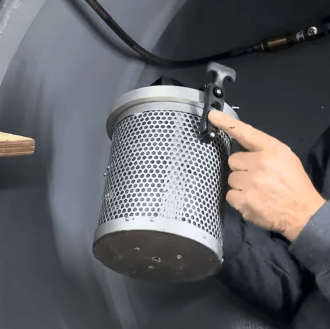

If you look around your environment, you can probably pick off quite a few things that you’ve made, at least if you’ve been at this a while. You probably aren’t reading this from the bottom of a body of water though, which means you lack the incredible confidence of submarine builder [Hank Pronk]. Not only is he building himself a capable-looking diesel-electric submarine over on YouTube, he’s even DIYing CO2 scrubbers for it! Yeah, that’s a man who believes in himself.
Luckily [Hank] is not anywhere near the Caribbean, so needn’t worry about being misidentified as a narco-sub, but he still has to be concerned about his oxygen supply when tooling around beneath the local lakes. Perhaps more important than the oxygen supply in a sub is the build up of CO2. It doesn’t matter how many oxygen tanks you bring down with you if you can’t scrub CO2 out of the air to make room for it. Just like the Apollo missions, he’s using a chemical adsorbent to take carbon dioxide out of the air — and just like Apollo 13, he’s switching from square to round.
Or, rather, from a rather rectangular commercial model to a DIY little round unit. That’s because he doesn’t need the big scrubber in this sub: being diesel-powered, he expects to spend a lot of time at snorkel depth, where both the pilot and the engines can get clean air through the tube. Dives are expected to be short, and in that use case, too big of a CO2 scrubber is really a waste. If for some reason he gets stuck on the bottom, well, the lake isn’t that deep. He can swim to surface, and has a detailed bailout plan. If he wants to stay under overnight to avoid bailing at night, he’s carrying enough extra adsorbent for that.

  2. Honestly, the scrubber is probably pretty low on the list of things to worry about DIY-ing on a homemade sub. Pretty low tech, hard to screw up, and well-trod territory: everything from tourist submarines, personal rebreather SCUBA gear, and all the way up to the Dragon Crew capsule use it.
    You really need to be able to measure the CO2 and O2 levels though, so you can tell when the sorbent is working well/exhausted, or when you need to add O2. The sorbents with colour-change indicator help with the former.
    1. You need to add oxygen to maintain a constant pressure, as removing the CO2 lowers the air pressure. Measuring is a good way to make sure everything is working correctly, but not necessary to control the oxygen. The gas meters we use at work before entering a confined space measure oxygen concentration and there are lots of CO2 meters out there, so it can’t be too hard.
      1. It’s a bad idea to rely just on ambient pressure to estimate oxygen content. There’s only a 10% difference in pressure between “normal” and “unconscious”.
        Rebreather oxygen sensors for exactly this purpose are commonly available and only around $100.
        On the other hand, even in a small sub of a few cubic meters volume, there’s enough usable oxygen (a few percent of the volume, so say 100 litres) to last you over an hour even without any replenishment: You only use a liter or so (1-2 grams) per minute.
        The problem is, you might not notice yourself going hypoxic. You’ll be giggling at the funny blueish color of your fingernails just before you pass out.

    3. Many subs use an altimeter (or other sensitive pressure measurement device). If pressure drops, you need to add more O2, if pressure is increasing, you are either adding too much O2, or your CO2 absorbent has stopped working.
      1. Exhaled CO2 occupies exactly the same volume as the O2 inhaled and used to make it: A pressure gauge won’t increase when the CO2 absorbent stops working. (in actuality, the pressure will decrease somewhat because some of that inhaled oxygen got burned to make water too, which will tend to condense out on the walls).
        In a sealed chamber, even a temperature change can cause a pressure change of the same magnitude as the difference between an atmosphere that you can be alert in, and one so oxygen deficient that it makes you incapable of thinking straight, or simply unconscious.
        A pressure gauge alone is a cheap but imprecise and really dumb way to estimate your breathing air’s oxygen content.
