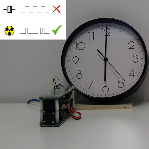

The Becquerel (Bq) is an SI unit of radioactivity: one becquerel is equivalent to one radioactive decay per second. That absolutely does not make it equivalent to one hertz — the random nature of radioactive decay means you’ll never get one pulse every second — but it does make it interesting. [mihai.cuciuc] certainly thought so, when he endeavored to create a clock that would tick at one becquerel.
The result is an interesting version of a Vetinari Clock, first conceived of by [Terry Pratchett] in his Discworld books. In the books, the irregular tick of the clock is used by Lord Vetinari as a form of psychological torture. For some reason, imposing this torture on ourselves has long been popular amongst hackers.
Without an impractical amount of shielding, any one-becquerel source would be swamped by background radiation, so [mihai] had to get creative. Luckily, he is the creator of the Pomelo gamma-ray spectroscope, which allowed him to be discriminating. He’s using an Am-241 source, but just looking for the characteristic 59.5 KeV gamma rays was not going to cut it at such a low count rate. Instead he’s using two of the Pomelo solid-state scintillation as a coincidence detector, with one tuned for the Am-241’s alpha emissions. When both detectors go off simultaneously, that counts as an event and triggers the clock to tick.
How he got exactly one becquerel of activity is a clever hack, too. The Am-241 source he has is far more active than one decay per second, but by varying the distance from the gamma detector he was able to cut down to one detection per second using the inverse square law and the shielding provided by Earth’s atmosphere. The result is a time signal that is a stable one hertz… if averaged over a long enough period. For now, anyway. As the Am-241 decays away, its activity decreases, and [mihai] admits the clock loses about 0.4 seconds per day.

  2. Worth noting that the claimed 0.4s/day loss is the natural decay rate of the sample, not the actual accuracy of the clock. I really hope [mihai] keeps this running for a while so we can see how well the clock part works. I’ve been running a similar project for more than a year, and I’ve found it pretty difficult to get better than a couple hundred PPM, although I’m using a regular geiger tube.

    1. I think it would be fun to make this as a closed loop system where the radiation source to detector distance is varied with a servo to approximate 1 count per second. This would of course rely on ANOTHER system to provide an accurate 1cps source, but still it would be funny.
  3. This won’t work as described on hack a day. CsI(Tl) crystals don’t scintillate off alpha consistently( rarely). Also the alpha particle won’t penetrate the plastic cover of the scintillation crystals.
    /Sr Radcon tech who has worked alpha exclusive facility.
    1. Hi! Actually that was the fun part of the challenge when I made this clock. The alpha source is enclosed in the same cover with one of the scintillators, so there’s just a few mm of air between the source and bare scintillator face. I did not mention it in the post but I used GAGG(Ce) for the alpha scintillator, and there is enough scintillation consistency to get a very broad peak from the alphas.
      1. Thank you for the clarification. That will indeed work. I figured some critical information was missing. I’m at work so I all I had time to explore was the hackaday article on this and your previous detector.
