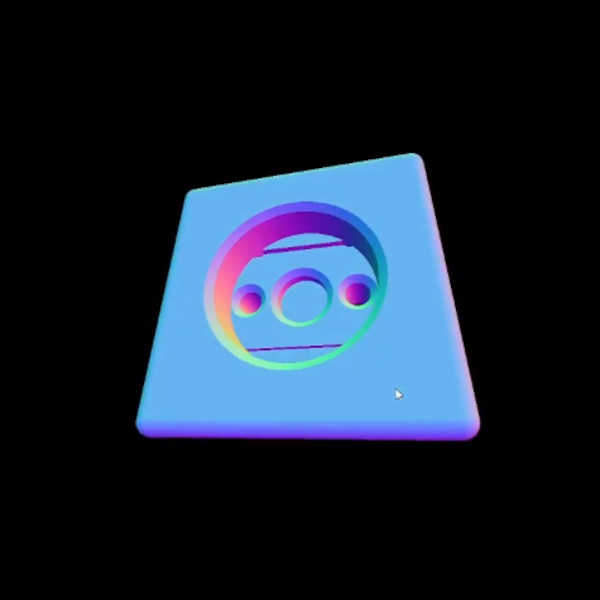

It’s likely that many of you use some form of CAD package, but how many of you have decided you didn’t like the software on offer? [Marcus Wu] did, and instead of griping, he wrote his own CAD software. It’s called MakerCAD, it’s published under an MIT licence, and you can try it yourself.
It’s written in Go, and it’s superficially similar to OpenSCAD in that the interface is through code. The similarity is skin deep though, as it provides the user with constraint solving as described in the video below the break.
As it stands it’s by no means feature complete, but it is now at a point at which it can be evaluated. Simple models can be created and exported as STEP files, so it can be used as a real-world CAD tool.
Whether it will flourish is down to the path it takes and how its community guides it. But we’re pleased to see any new open source projects in this space, which remains overly dominated by proprietary packages. If you try it, write up your experiences, we’d love to see how this develops.

    1. As the creator of MakerCAD, I agree and I have plans to keep it expressive while reducing the verbosity. I also intend to build a UI in the future which will provide a traditional interactive CAD producing the code behind the scenes, but without requiring the user to write it.
        1. It’s pretty hard to create a point & click interface that would output in human-readable code unless you perform the pointing and clicking operations exactly right in a proper order.
          There’s a general point in UI/UX design that you should not be able to effect the same thing in two completely different ways (e.g. by GUI and CLI) at the same time, because one messes up the other. In other words, you can write code that performs something impossible for the graphical interface, which breaks the latter because attempting to touch the same feature with your mouse cursor can then break your code.
          1. That’s exactly correct. The UI will generate code, but modify that code and the UI will not reflect those changes. I plan on using some annotations to allow the UI to be able to edit things it had generated in a previous session, but stray from that and you will have to continue editing code directly.

    1. Planes are one way to go, but you can also use a face of an existing shape to create a sketch or primitive from.
      You’re absolutely correct about Go and MakerCAD’s relationship. The language and syntax is Go and MakerCAD is a library / package for doing CAD work. Yes, parallelization would be handled through Go’s mechanisms. I am not sure how much of that is necessary, but as others and I build more complex things with MakerCAD perhaps it will become so.
      Yes, constraints are definitely there to solve math issues that are harder to by hand. In the miwa vise block example (https://github.com/marcuswu/miwa-vise-block) I create a sketch where I want to cut a channel within a circular cut, so the walls are basically cords across the circular shape including arcs that are subsets of the larger circle. Calculating the points for those cords and arcs could be done by hand or with formulas in the Go code, but instead I can simply define my intent to the sketcher and let it solve it for me.
      Yeah, OpenCascade was kind of a leg up for the project. It was one of the few open source brep based cad kernels I could find. Perhaps I will eventually reach a point with this that I take the hit to write my own cad kernel in Go.
      Are you talking about mathematically defining splines? Currently MakerCAD does not have spline support, but it is definitely a feature I would plan to add.
      It sounds like you are doing some very cool things with OpenSCAD. I’d love to see what you might come up with using MakerCAD. If you try it out and find specific things you want added, I’d love to hear about them.
