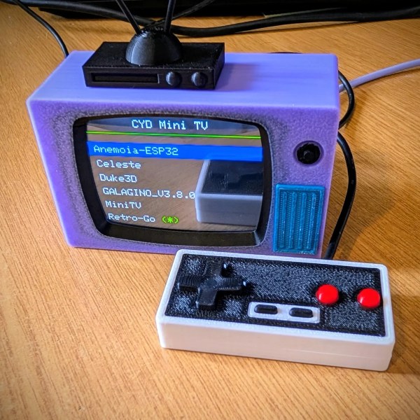

The ‘Cheap Yellow Display’, or CYD, is becoming a staple in these circles, and with good reason: just like the name says, it’s cheap, it has a display, and of course an ESP32 microcontroller to give it lots of brainpower. What it doesn’t come with is a lot of RAM, which was a problem for [DynaMite]’s project. What was there to do but solder on more PSRAM so the CYD could become a mini TV for retrogaming?

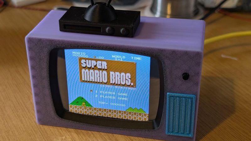

Depending what you want to play, you might not need the extra memory. In [DynaMite]’s case, he wanted to run Retro-Go, which opens up a lot more than just the standard NES emulator you can run on an unmodified CYD — including 16-bit systems like the SNES and Sega Genesis/MegaDrive or even DOOM. Adding the PSRAM is just a matter of getting the little chip onto an unpopulated footprint on the board, cutting some traces, and adding a bodge wire. It’s not nothing, but it’s not impossible.
While he was slinging solder, [DynaMite] also took the time to swap some resistors in a step that apparently does great things for the CYD’s sound output, which is… not great, from stock. For really good sound, you really need to break out I2S, but for a tiny game system this is doubtless good enough.
The whole thing goes into a lovely retro TV case that takes its design cues from The Simpsons, which is available via the link as a STEP file as well as STLs. He’s also got a vibe-coded video player application — think of it like the VCR, maybe —and a launcher that will switch betwixt that and the emulator or any other applications stored as .bin files on an SD-card. Check it out in action in the demo video below.
