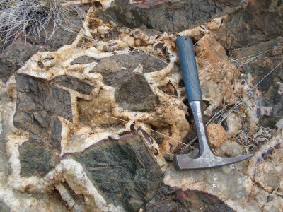

When you’re using your hammer for scale next to the crystals, you know it’s a pegmatite. This example is from Radium Creek, Arkaroola, South Australia. Image: Geomartin, CC-BY-SA 4.0
Again, we’re talking about a fluid that’s hundreds of degrees Celsius: seriously supercritical stuff. It can carry a lot of ions. Circulating through the magma chamber, this ion-rich fluid brings each crystal all the metal ions it needs to grow to its full potential. Maybe that’s a garnet the size of your fist, or feldspar crystals like pink playing cards. The ions in the fluid can be leftovers from the earlier melt, but may also include material scoured from surrounding rocks.

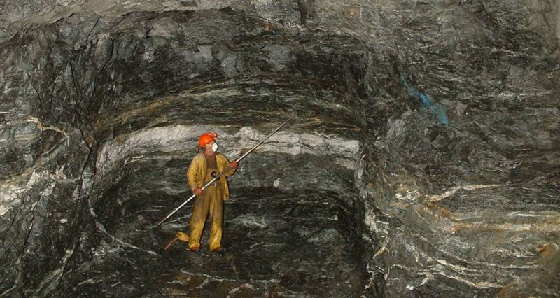

The white quartz vein follows the fissures in the rock hydrothermal fluid once flowed through. “Main Vein (hydrothermal quartz-gold vein), subsurface exposure in Nalunaq Gold Mine, southern Greenland” by James St. John, CC BY 2.0
That doesn’t mean you need to look near mountains: the gold fields of Kirkland Lake, mentioned last time, are actually an orogenic deposit, and Kirkland Lake sits near the middle of the Canadian Shield, as far from any (modern) mountains as you are likely to find. There may have been mountains there, once, but they were eroded away by the time the Dinosaurs walked the Earth. What you will find there are shocking white veins of quartz shooting through the granite of the Canadian Shield– evidence of the hydrothermal fluid’s ability to carry dissolved silica through fissures of the rock– interspersed with flecks and pebbles of gold. Most gold started in hydrothermal deposits like this one, but in an ironic twist, most of the gold humans have mined is actually from a different type of deposit we’ll get to later. For now we’ll say there are secondary processes at work on this planet and leave it at that.

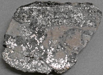

Native Silver, from a mine that closed in 1887. Image: “Native silver in hydrothermal vein rock (Proterozoic; Silver Islet Mine, Lake Superior, Ontario, Canada) 1” by James St. John, CC BY 2.0
Gold isn’t the only thing to be found in these hydrothermal veins: native silver and copper mines have also been found chasing quartz veins. Cobalt, Molybdenum, even Tin and Tungsten may be found, though not necessarily in native form. To a geologist, note that the word “native” has nothing to do with tribal affiliation, and everything to do with elemental composition. “Native” metals are just that: metals. Native copper is a lump of Cu, not chemically bound into any mineral.
