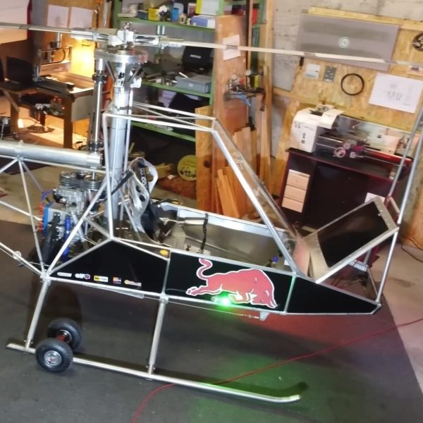

Ultralight aviation provides an excellent pathway for those who want to fly, but don’t want to get licensed. These quite often cheap and cheerful DIY aircraft often hide some excellent engineering underneath. This is no more true than in [ultralight helicopter’s] four-year-long helicopter build saga!
While most ultralight builds are fixed-wing, a rotocraft can meet all the legal definitions of ultralight aviation. This helicopter is an excellent example of what’s possible with a lot of time and patience. The construction is largely aluminium with some stainless steel on the skids. A 64-horsepower Rotax 582UL engine powers the two-bladed main rotor and tail rotor. The drivetrain features a multi-belt engine coupler and three gearboxes to ensure correct power output to the two rotors.
It features a control layout familiar to any helicopter pilot with foot pedals that control the tail rotor pitch for anti-torque control. A cyclic in front of the pilot controls the rotor’s cyclical movements, resulting in forward and sideways flight control. A collective with integrated throttle controls the overall main rotor pitch for altitude and climb control. Finally, a simple clutch sits next to the collective for engine start and idles.
The build was meticulous, with nearly everything from the swashplate to the gearboxes custom-machined. The balance and alignment of everything, from the rotor blades to the input trim, had to be checked. The build is a masterpiece of home workshop engineering.

  1. Yes, this is an impressive build, but I would not call it “meticulous” or a “masterpiece” Weight of a helicopter is quite important and this once seems a bit heavy in a lot of ways. For example, why the (nearly) 1:1 multi V combined with the big gears on the top? The big steel gear on the top also looks like it’s some standard gear and could be made a lot lighter. The gearbox for that gear also has a very thick sidewall, while normally such walls are just a few mm thick, with thicker sections for where the bolts are.
    Shaving off 20kg may not seem like much, but it directly translates to an increased flight time. Small helicopters need some 30 to 50kg of fuel per hour, so even 20kg is quite significant.
    I did not see a website with more info. According to his youtube channel, the guy is from Switzerland (surprising). I’m not sure whether he designed the whole thing himself, or started with some kit. From the “roughness” of the overall design, it looks like it’s a completely DIY design. USA is quite generous in regulations around “experimental” aircraft. Here in Europe it’s a bit more restricted, but I don’t know more details.
    1. Agreed! Even the R22 is mostly flown without doors for the same reason. With two people in there you can’t even fill the gas tank all the way and make gross takeoff weight.

    2. They say this is an ultralight. In the US any recreational aircraft with a single seat, 5 gallons (19L) or less fuel capacity, and a weight of 254 pounds (115kg) or less with a maximum stall speed of 24 knots does not require annual inspections, airworthiness certificates, or pilot licenses.

    3. Your fuel consumption is ballparking a R44 (57L 41kg) to R66 (87l or 62kg) turbine aircraft both in the 200hp.
      The total consumption of the 582 is given for 16L or 12kg per hour which is not great mainly because it is 2strokes. 100Hp Rotax are doing the same but weighs more.
      So yeah weight is everything in helicopter but your assumptions are way off.

  4. Minute 2 or so of the video and I cringe at the single nuts being used (they are self-locking, but that rubber may fail because of the vibrations).
    Landing gear has no amortisation or crumbling area in case of had landing.

    1. “explosive bolts and a big parachute” are pretty much useless for ultralight helicopters. When they fail they fall like a rock, and they are rarely flown high enough for parachute deployment to be practical.
        1. Minimal chance for it to be effective, and then ONLY when there is the ability to disconnect the rotor from the drive, which few ultralight helis are designed to do.
          1. All helis, even ultralights, have freewheel clutches (I think I saw it mentioned in the video). You REALLY want the main rotor to continue to spin if the transmission or engine seizes.
        2. Most people think helicopters are way safe because you can just autorotate if you have a power failure. Unfortunately, for most heli flight modes, that just isn’t the case. In particular, you must have a certain amount of forward speed and/or altitude (total energy) to even be within the parameters necessary to autorotate. If you are going low or slow (or both) you simply do not have enough energy to autorotate, and you are for all intents and purposes a non-flying rock. Uncontrollable, too, as a bonus! And flying low and/or slow is most of what helis do.
