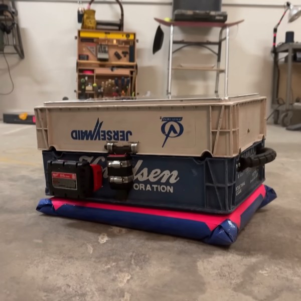

A suitcase made of two rectangular plastic crates latched together sits prone on a concrete floor. The top shell is a beige-ish grey with a navy check and the word "JerseyMaid" on it updside down. The navy bottom crate is navy with the letters "lsen" in large cursive font ant the letters "ORATION" in smaller print below it. Much of the text is covered by a large latch and a power tool battery mount. Bright pink tape affixes a blue tarp skirt to the bottom of the hover suitcase.
The wheels on roller suitcases are one of their primary failure points. After the destruction of the wheel mount on her DIY suitcase, [Laura Kampf] wondered if it would be better to dispense with wheels altogether.
To give her suitcase a lift, [Kampf] decided to turn it into a hovercraft so it couldn’t be stopped by pavement or puddles. The first task was finding an appropriate fan, and a compact leaf blower donated it’s body to makerdom for the project. After reducing the blower to it’s constituent components and finding a secret turbo switch, work began on the momentum curtain.
“Nose-holing” the arrangement and size of the holes to pipe air through the stapled tarp and tape skirt seemed to be the bulk of the trial-and-error in this one. Based on other hovercraft designs [Kampf] found, keeping the holes near the center of the inflated portion gave better lift. In the end, the carry-on is able to lift a decent amount even on its lowest setting, resulting in a suitcase that is “not embarrassing” for travel. No word yet on what TSA thinks.

  2. When it doesn’t have the extra weight, you can see the side where the air is blowing is higher. If you split the airflow to distribute it, I think it would help balance it better. Also, instead of the leash, I would rig up something like the extending handle to the front and wire in the switch into the handle for turning it off and on.
    1. add some distance sensors to the corners, an arduino controller and a way to route the air flow around and you have an upside down drone.
