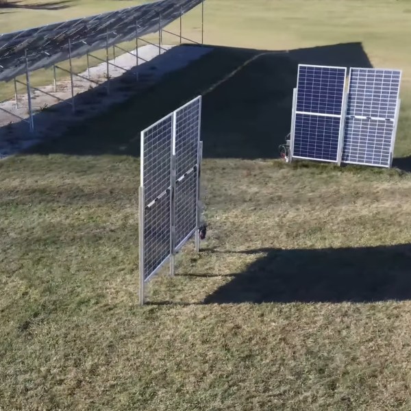

If you’re mounting solar panels, everybody knows the drill, right? Point them south, angled according to latitude. It’s easy. In a video which demonstrates that [Everyday Dave] is truly out standing in his field, we hear a different story. [Dave] has a year’s worth of data in his Solar Panel Showdown that suggests there are good reasons to mount your panels vertically.
Specifically, [Dave] is using bifacial solar panels– panels that have cells on both sides. In his preferred orientation, one side faces South, while the other faces North. [Dave] is in the Northern Hemisphere, so those of you Down Under would have to do the opposite, pointing one face North and the other South.
Since [Dave] is far from the equator, the N/S vertical orientation beats the pants off of East-West facing panels, especially in winter. What’s interesting is how much better the bifacial panels do compared to the “standard” tilted orientation. While peak power in the summer is much better with the tilted bifacial panels (indeed, even the tilted single-sided panels), in winter the vertical N/S panels blow them out of the water. (Especially when snow gets involved. Vertical panels don’t need sweeping!)
Even in the summer, though, there are advantages: the N/S panels may produce less power overall, but they give a trickle earlier and later in the day than the tilted orientation. Still, that extra peak power really shows, and over a six-month period from solstice-to-solstice, the vertical panels only produced 77% what the tilted bifacial panels did (while tilted single-sided panels produced 90%).
Is it worth it? That depends on your use case. If most of the power is going to A/C, you’ll need the extra in the warmer months. In that case, you want to tilt the panels. If you have a steady, predictable load, though, having even production winter/summer might be more to your liking– in that case you can join [Dave] in sticking solar panels straight up and down.
These results probably apply at latitudes similar to [Dave] who is in cloudy and snowy Ohio, which is perhaps not the ideal place for solar experimentation. If you’re not an Ohio-like distance from the equator, you might find an East-West array is the best bang for the buck. Of course if you really want to max out power from each individual cell, you can’t beat sun tracking regardless of where you are.

  1. One word: wind.
    I’ve not watched the video. Keeping large sail like panels vertical in areas with high winds for 20 years will require some major anchoring and very deep foundations. And the risk of shadows across multiple cells from guy wires means that they can not be used.
    1. It really won’t be that bad unless you get very large – your average low effort built to a price housing estate fencepost is only foot or two deep in dirt, maybe a little rubble backfill and they last well enough, maybe not 20 years but a good while. Switch up to doing it properly with the concrete fenceposts…
      Also just how high winds are you talking about? As the difference between panels mounted tilted or vertical on the ground for wind catching and forces on the mounts could end up being much tougher to survive with the tilted panels acting like an aerofoiil and actively lifting up while the vertical panels just create a dead air space.
      1. I’m not as much worried about the posts, but the panel itself getting rattled to pieces with the wind. It’s a sandwich of glass with fragile wires in between, after all.
        1. can’t say i’ve tried it but i’ve helped sling panels before and they are typically pretty mechanically stable. it’s tempered glass fairly well-anchored to the metal frame. so long as the frame is well-supported, installers can even put their weight in the center of the glass. what i’m saying is, i can’t hardly imagine it rattling. i know they’ll pull a post out of the ground but rattling seems unlikely.
          1. What I’m worried is when the post or the panel inevitably comes loose, the panel will start to flap and flex with the wind, and that will grind at the mounting points and edges where the stresses are concentrated. The edges of the panel will chip or crack and delaminate, moisture gets in, and the panel is ruined after a couple years.
        2. If they can’t take that they are not suitable for regular use at all – the very nature of them is to be pelted by hailstone, pulled at by high winds etc. They are not impervious, but they are really not fragile.
          1. It’s one thing to be pelted by hails, and another when the entire panel acts as a sail in gusty winds and puts significant forces on the mounting points.
    2. that’s true but anchoring is already the biggest part of installing panels independently of a building. when my electrician friend went into solar installation, he had to buy a bunch of digging equipment and now orders concrete in whole numbers of yards. he’s also gotten to clean up after people (and distribute free dented panels to his friends) from installations that were improperly anchored and blew over.
      i mean if you think about it, an angled sail puts a ton of force already. a straight vertical sail is only marginally worse.

  3. I guess this North/South or South/North orientation only really pays off in the snow. For most of the planet, you are wasting your time putting 50% of your capacity into permanent shadow.
    1. Not totally true – Up here in Finland, during the summer the sun can be in the south from early morning to early evening and in the north the other side of the day.
      I have two panels on the roof of a storeroom/workshop/shed with two panels, one facing due south, the other not-quite due north as it faces the big gap in the trees. Both panels are mounted vertically too.
      The system works very well.
      1. the sun can be in the south from early morning to early evening
        No it can’t. Even in northern hemispheres, the sun rises from the east and sets to west. If you’re up above the arctic circle where the sun never sets, it starts from north, circles around to south, and then goes back north. In either case, at 6 AM the sun is shining from east, 12 AM it’s south, and 6 PM it’s west, 12 PM or midnight it’s in the north.
        If you calculate where the sun would be at 9 PM in July in Helsinki, it would be about 6.5 degrees up from the horizon north-west, and when it’s so low in the horizon the light is passing through a lot more air, which makes the direct brightness about 20% of what it would be in the middle of the day. The light has to travel through hundreds of kilometers of air and whatever is suspended in the air, like water vapor and air pollution, which is why sunsets are red.
        For the same reason, when the midnight sun is in the north, the actual direct brightness is reduced to 2-3%. So, if you place the panels north-south, any time the sun is facing the panel from north-west through north, to north-east, between 9 pm to 3 AM, it would be too low in the horizon to actually do much.
        1. OP said “only really pays off with snow” and “putting 50% of your capacity into permanent shadow”, which is not correct as alloydog pointed out- anywhere north of the equator between the spring and fall equinox the sun will rise north of straight east (90°) and set north of straight West (270°), the effect being more exaggerated the further north of the equator you are. I’m in MI, USA a little north of 43° latitude, at the summer solstice the sun rises at 56°NE and sets at 304°NW and the sun spends >6 hours per day north of straight east or west, with over half that at greater than 15° above the horizon, meaning you’ll still get reasonably good production. All in all it means for at least 4 months out of the year a north facing panel would receive ~1-3 hours per day of sunlight at a good production intensity. I’m sure that would be even more exaggerated at 60° north latitude in Helsinki.
          1. Mind that the panels don’t get full power when the sun is off-normal from the panel. This is because of shading by the collector wires and partial reflection inside the glass, total reflection off the glass, etc. Essentially, the panel has a “viewing angle” with some percentage points loss of efficiency for every hour the sun is offset in angle. This is in addition to the fact that the panel covers a physically smaller area towards the sun when it’s at an angle, and therefore receives less power.
            So when the sun is north of east or west, it has to be far enough north to face the panel or it just won’t do anything, but the further north it goes the lower in the horizon it gets, so that won’t help you either.
            So, of the 1-3 extra hours that you might catch, most of it will be at low intensity or from a bad angle, so it may not contribute more than 5% extra output per day.
    2. Not really – the scattered light that will reach the shadowed panel is still meaningful amount of energy capture and the cost of the panel itself is almost nothing compared to all the other costs – the mounts, the inverters, and the usually required planning permissions and qualified electrician ends up being the lions share of the cost.
      So while you don’t get the same return on investment as if you could mount it pointing more to the sun on the panel alone it will still be a meaningful gain for relatively little cost, so if you have the money for more but not the space or money to cover a wider area with primary oriented panels…
  4. not watched video either, but the graph that is visible indicated a january day, when the sun would be very low in the sky

  8. The main problem with vertical – apart from the wind – is you’d need a nice empty farm to put them in..
    I suspect vertical would also work better at a higher latitude..
    I’m in Aus close to the tropic line – so in summer the sun is straight up – and what I’ve done is put panels on the east, west, and north. So at the spring equinox I get power from 6am till 5.30pm. And from 8am till 4pm more power than I can use..

  9. Although a joke, the backside of the panel is less effective, so the panels should indeed be oriented the other way around south of the equator.
    I am curious to try a bifacial up here in the snow, but in the winter the sun never rises above the horizon, so it would be spring/fall for me (think northern part of alaska)
    1. Not if you anchor it properly.
      Most of our environmental monitoring stations use solar-panels mounted vertically and have ground anchors hammered about 75 cm into the ground. In 13-years, the only ones that have fallen over have been hit by mining trucks.

  12. My only gripe is that [Dave] appears to have put the panels close enough to each other that they’re in danger of shading each other at certain times and skewing the data.
    Otherwise it’s great to see some solid data rather than the usual mix of either super optimistic marketing BS or anti-renewables FUD that permeates the internet.
  13. I’d be concerned about wind loading. The vertical mounted panels both EW and NS would be subject to high loading when the wind is up. For large numbered installations there would be several solutions to mitigate this
