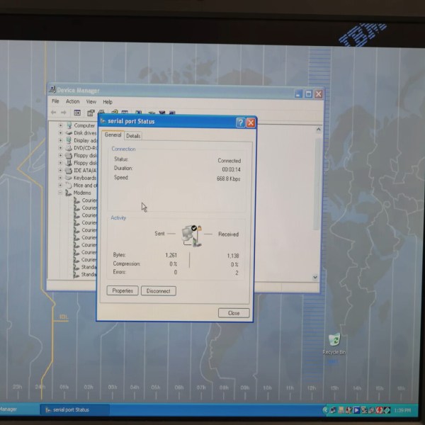

Testing with a mere four modems showed that Windows XP had far better multilink support, with all the modems creating a cacophony of sound dialing simultaneously. Unfortunately, this test with four modems failed due to numerous issues ranging from dial tones to hardware failures. As it turned out the DIP switches on the bottom of the modems needed to be set identically. After a few reterminating cables, three of the four modems worked.
The next set was eight modems. Despite persistent connection issues, five modems got connected in this next test with just over 200 kbps, 2000 era broadband speeds. But a neat feature of multilink is the ability to selectively re-dial, so by re-trying the connection of the three unconnected modems, all eight could work in parallel, reaching over 300 kbps.
But still, this is not enough. So after adding more phone lines and scrounging up some more modems, an additional four modems got added to the computer. With twelve modems connected, a whopping 668.8 kbps was achieved over dial up, well in excess of what’s needed for YouTube video playback, and even beating out broadband of the era. Despite this logical extreme, there is still no theoretical limit in sight, so make sure to stay tuned for the next dial up speed record attempt!
