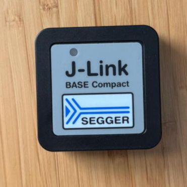

Segger’s Awkward USB-C Issue With The J-Link Compact Debugger
Theoretically USB-C is a pretty nifty connector, but the reality is that it mostly provides many exciting new ways to make your device not work as expected. With the gory details covered by [Alvaro], the latest to join the party is Segger, with its J-Link BASE Compact MCU debugger displaying the same behavior which we saw back when the Raspberry Pi 4 was released in 2019. Back then so-called e-marked USB-C cables failed to power the SBC, much like how this particular J-Link unit refuses to power up when connected using one of those special USB-C cables.
We covered the issue in great detail back then, discussing how the CC1 and CC1 connections need to be wired up correctly with appropriate resistors in order for the USB-C supply – like a host PC – to provide power to the device. As [Alvaro] discovered through some investigation, this unit made basically the same mistake as the RPi 4B SBC before the corrected design. This involves wiring CC1 and CC2 together and as a result seeing the same <1 kOhm resistance on the active CC line, meaning that to the host device you just hooked up a USB-C audio dongle, which obviously shouldn’t be supplied with power.
Although it’s not easy to tell when this particular J-Link device was produced, the PCB notes its revision as v12.1, so presumably it’s not the first rodeo for this general design, and the product page already shows a different label than for the device that [Alvaro] has. It’s possible that it originally was sloppily converted from a previous micro-USB-powered design where CC lines do not exist and things Just Work™, but it’s still a pretty major oversight from what should be a reputable brand selling a device that costs €400 + VAT, rather than a reputable brand selling a <$100 SBC.
For any in the audience who have one of these USB-C-powered debuggers, does yours work with e-marked cables, and what is the revision and/or purchase date?

  1. Why do people use SEGGER? Is the J-* tool ecosystem really that good? Is the RTT/ETM trace output really better than reading a fixed RAM section every couple of cycles to get the log? I mean that IS what RTT is, isn’t it?
    Don’t get me wrong, I use their tools as well but I don’t think they’re unique in their functionality. CMSIS-DAP does everything too
    1. The big appeal is this. I can literally go to ANY computer use their tools/software and everything just works. This includes about every Linux or bsd distro, Mac, Windows computer you can think of… I don’t have to worry about anything. Their tools support command line and even scripting interfacing as well as a good-ol gui of that’s your speed.
      Again they just work…
    2. You’ve already answered the question yourself. Yes, yes, and yes. There are even better ones, like the Lauterbach debugger, but you certainly don’t want to pay for that. You don’t seem to know much about it. RTT does indeed read a fixed RAM section. ETM is part of CMSIS-DAP. There are also people who use things for more than just their hobby. Time is money and having reliable, consistent and convenient products is key.
    3. I’m a 30+ year Linux vet and have used every FOSS debugging tool made and I still own a JLink Pro. As others above have pointed out, it just works… I often run the GDB server on Windows due proximity to the target and connect with GDB ext remote from Linux. Solid tool and good support from Segger.
    4. For me Ozone is the biggest selling point. You can debug without using the -debug compile option so I can track down the actually problem especially when dealing with time sensitive stuff like DMA moving memory around.
      Also it just works. I haven’t used the USB-C version but I haven’t seen any issues with the micro USB version.
    5. You don’t strictly need Segger’s tools to use RTT, but e.g. OpenOCD’s implementation is pretty janky.
      The appeal of Segger is that their tools and dongles generally Just Work (the USB-C connector issue notwithstanding), and are robust enough for production use. They also scale up with trace-capable tools, and the battery-powered programmers can be a godsend for field techs. The hardware upgrade/exchange program is also nice, though I do think the base units are way too expensive.
    6. It is. Adding an unsupported device is three C functions(One to erase flash, one to write a chunk, and one to read a chunk), a handful of configuration lines for the memory map and flash sizes, and then it pretty much Just Works. Very little debugging of the debugger.

  4. i don’t understand what “e-marked cable” means but a quick googling makes them sound like premium cables you have to go out of your way to obtain?
    what i like about usb-c is that it all ‘just works’ for me. i never needed to go hunting for a specialty usb-c cable, so i never have. i have a couple long usb-c cables i bought for extension purposes, but mostly i use leftover cables that came included in the box with phones and doodads.
    i think the question about what kind of experience you should expect from a $400 device is, do they do what’s necessary to make it work? does it come with a cable that works with most computers? if you email their tech support, will they tell you to try the stock cable, and will that solve your problem?
    i don’t believe in idealism. the abstract compatibility question doesn’t matter, the real question is whether it ‘just works’.
