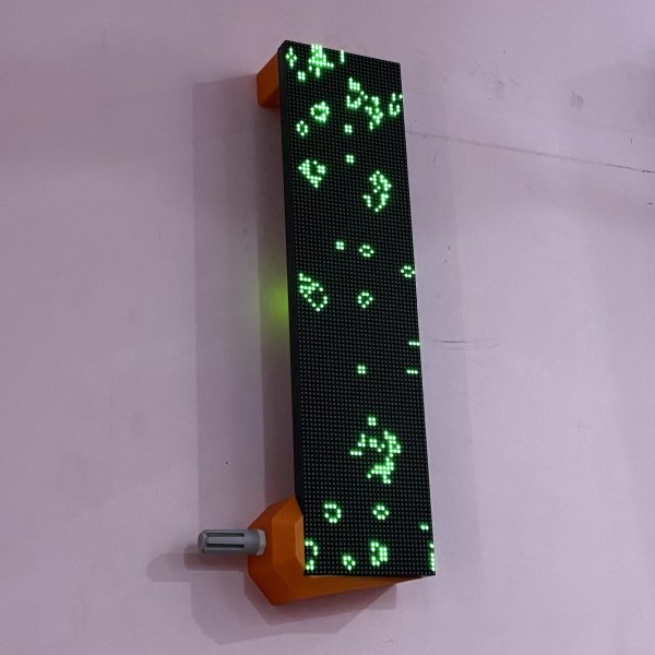

The problem with air quality is that you can’t really tell how good or bad it is just by looking…unless it’s really bad, that is. It’s usually more helpful to have some kind of sensor that can tell you what the deal is. To that end, [Arnov Sharma] built a neat air quality monitor with a fun twist.
A Raspberry Pi Pico W acts as the heart of the build, armed with an SGP40 gas sensor. This sensor is intended for monitoring total volatile organic compounds in the air, which can be a useful measure of air quality in at least one dimension. It reports a simple air quality score from 0 to 500, based on a 1-1000 ppm ethanol equivalent reading. Based on the sensor’s output, the Pi Pico drives an LED matrix display — setting it green for good quality air, yellow for moderate, and red for poor air quality (i.e. high VOC content). The fun part is that rather than just show a simple color, the display plays Conway’s Game of Life to create an animated visual. We’d love it even more if poor air quality lead to the premature death of individual cells, making it even more interactive.

  2. I think it would be far more effective if the game was affected by the air quality. If the air quality is really bad all the creatures (sprites? elements?) would be flopping around at the bottom of the screen.
    1. Conway’s Game of Life doesn’t really work that way but what the AQI sensor could do is influence the number of random spawns/deaths on the board. I’d think that higher AQI = more spawns would be a great way to make the visual work, since that’d lead to a more cluttered and chaotic board, having the pixels represent pollution rather than life.
      1. Fits well too – since mold is part of VOCs – like a little simulation of all the bacteria.
        Also the effect could be accomplished with a number of off screen glider generators :) more bacteria, more generators
