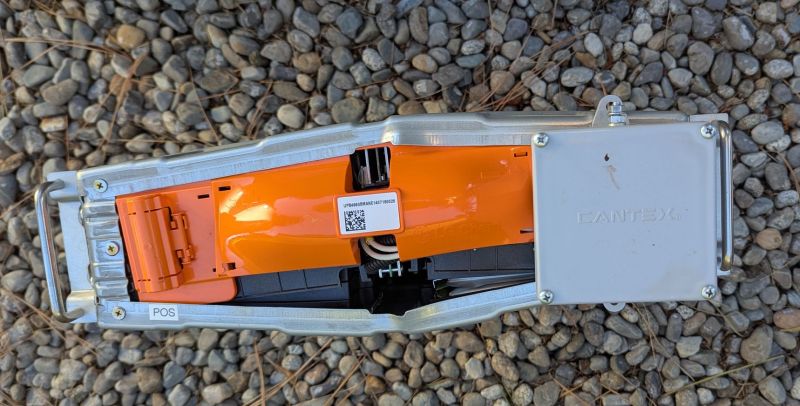

I generally only go in the trailer once a month or so, just to check things over and make sure no critters — or squatters — have taken up residence. Apparently, my inspections had become somewhat cursory, because somehow I had managed to overlook a major problem brewing:
This is one of two homebrew server rack battery modules I used in the trailer’s first battery bank. The LG-branded modules were removed from service and sold second-hand by Battery Hookup; I stripped the proprietary management cards out of the packs and installed a 100-amp BMS, plus the comically oversized junction box for wiring. They worked pretty well for a couple of months, but I eventually got enough money together to buy a pair of larger, new-manufacture server-rack modules from Ruixu, and I disconnected the DIY batteries and put them aside in the trailer.
Glass Houses
As for what happened to these batteries (while not as dramatic, the case on the other one is obviously swelling, too), I’m not sure. There was no chance for physical damage inside the trailer, and neither battery was dropped or penetrated. Whatever happened must have been caused by normal aging of the 28 pouch cells within, or possibly the thermal swings inside the trailer.
Either way, some of the pouches have obviously transformed into “spicy pillows” thanks to the chemical decomposition of their electrodes and electrolytes, creating CO2 and CO gas under enough pressure to deform the 14-gauge steel case of the modules. It’s a pretty impressive display of power when you think about it, and downright terrifying.
I know that posting this is likely going to open me up to considerable criticism in the comments, much of it deserved. I was clearly negligent here, at least in how I chose to store these batteries once I removed them from service. You can also ding me for trying to save a few bucks by buying second-hand batteries and modifying them myself, but let those of you who have never shaken hands with danger cast the first stone.
To my credit, I did mention in my original write-up that, “While these batteries work fine for what they are, I have to admit that their homebrew nature gnawed at me. The idea that a simple wiring mistake could result in a fire that would destroy years of hard work was hard to handle.” But really, the risk posed by these batteries, not just to the years of work I put into the trailer, but also the fire danger to my garage and my neighbor’s boat, camper, and truck, all of which are close to the trailer, makes me a little queasy when I think about it.

The ‘POS’ sticker on that battery does seem accurate, at least! ;)
As for what you should do… I think you said it in the last paragraph. At the very least, I don’t think you’d lose anything by seeing if they’d accept the batteries for recycling, other than a little time – the absolute worst they can do is to say ‘no’.

At least it’s LiFePo4, that’s likely the only reason it didn’t catch fire. But sounds like those batteries might have had a defect (hence why LG or whatever got rid of them), or they got too cold. LiFePo4 might not ‘halt and catch fire’ like standard Lion, but they do expand when mistreated or faulty. I’ve learned that the hard way from low grade cells. Some LiFePo4 cell types will expand somewhat over their useful life (specifically the pouch type), and this is normal to a certain extent. But not like this. Low quality ones will expand more.
This is also why pyramidal and (especially) cylindrical cells are much more common in larger, higher power battery packs as they are more highly expansion resistant due to the cell itself holding the pressure.
Check local recycling centers, in the US, many will take Lion, for a fee usually.
Also, general note for Lion: don’t set them on fire or dispose of them in trash, even if they are at 0v- they are still a major fire hazard and can still self ignite when fully discharged if they are punctured or crushed (like in a garbage truck). And they give off poisonous gas which goes without saying you shouldn’t breathe.
But this does not necessarily mean the other (not so expanded) cells of the battery are actually bad, there just might have been one factory bad cell. If it is cold damaged though, then I’d consider using the other ones only after watching several power cycles and seeing if they expand or heat up unusually. All in all, LiFePo4 is rather robust.
For Dan’s particular case, it’s probably a combination of elevated temperatures and over-discharge due to some quiescent current draw in his custom BMS (or even something parasitic). Those two can result in gas generation even though the cell is supposedly disconnected and being stored, and the cells may have remained fine if they were in service and the state of charge maintained above a critical level.
