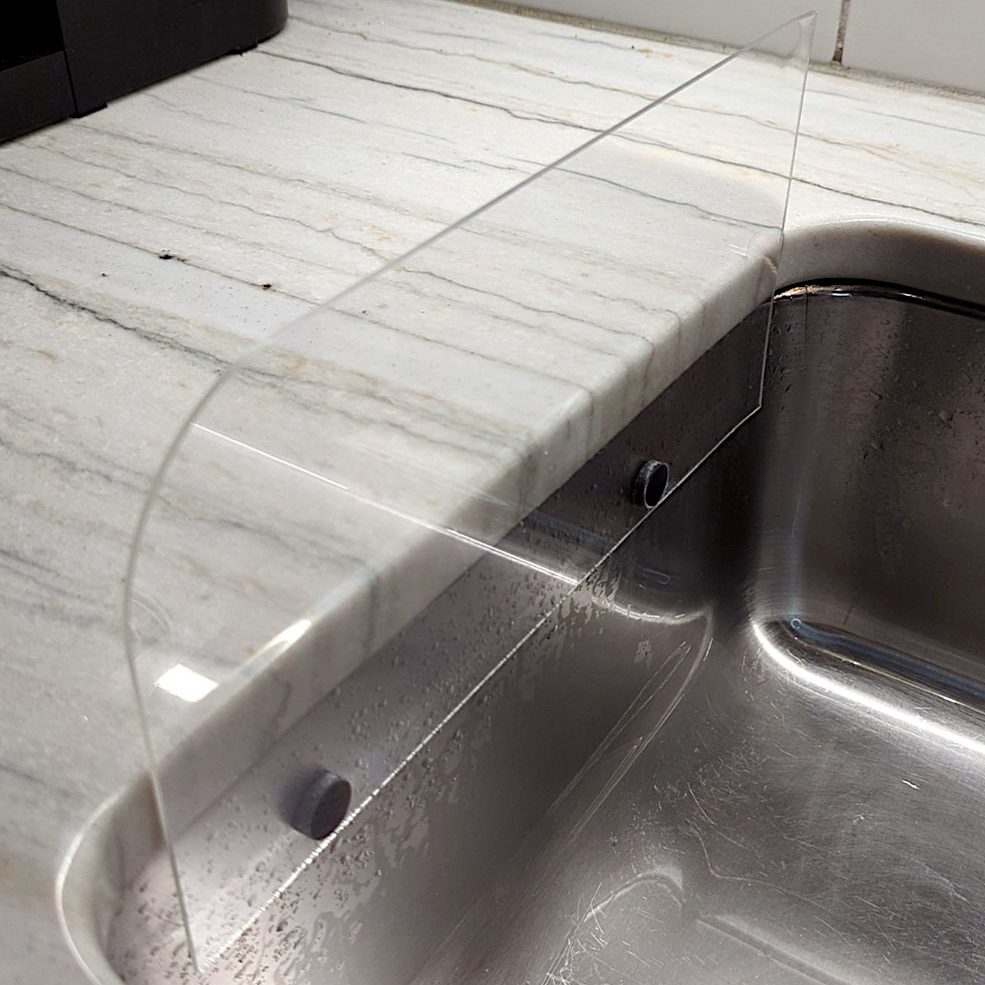

If you’re blessed with high water pressure at home, you probably love how it helps blast grime from your dishes and provides a pleasant washing experience. However, it can also cause a wonderful mess when that water splashes all over your countertops. [vgmllr] has whipped up a simple solution to this problem by installing an automatic splash guard.
The concept is simple enough—install a pair of flat guards that raise up when the sink is running, in order to stop water getting everywhere. To achieve this, [vgmllr] grabbed an Arduino, and hooked it up to a piezo element, which acts as a water sensor.
The piezo is attached to the bottom of the sink, and effectively acts as a microphone, hooked up to one of the Arduino’s analog-to-digital pins. When water flow is detected, the Arduino commands two servos to raise a pair of 3D printed arms that run up and down the outside of the sink. Each arm is fitted with magnets, which mate with another pair of magnets on the splash shields inside the sink. When the arms go up, the splash shields go up, and when the arms go down, the splash shields go down.
It’s an ingenious design, mostly because the installation is so clean and seamless. By using magnets to move the splash shields, [vgmllr] eliminated any need to drill through the sink, or deal with any pesky seals or potential water leaks. Plus, if the splash shields are getting in the way of something, they can easily be popped off without having to disassemble the entire mechanism.
It’s a tidy little build, both practical and well-engineered. It’s not as advanced as other kitchen automations we’ve seen before, but it’s elegant in its simple utility.

I have a feeling it is very noisy though and it will leave marks on the sink, but honestly this is the kind of thing that has enough product and industrial design thought that I expect the author is a professional in a related field.

Simple would be the plastic splash guard running in small 3d printed tracks on the edge of the counter. Slightly more complicated but keeping the clean look, splash guard with magnets on it, and magnets on the other side holding it there, and some 3d printed tracks on those to hold them there if you remove the guard entirely. Pull it up when you need it, push it down when you’re done. Or you can have two sets of magnets, one high and one low, fixed in place, alleviating the “scraping magnets on your sink surface” issue. Bonus feature, the guard can be in place before water starts flowing and potentially splashing, instead of being reactionary. No microcontroller or code necessary. Not even a 555. But it wouldn’t make it on HaD.

You don’t HAVE to use clear plastic, you can use any plastic you want, or even use a rustproof metal.
Also when the thing is down, in the sink, it should be easy to rinse off right?

Amazing idea and clean execution! the magnetic panels are genius: they dryp dry in the sink and are easy to detach/clean, and all the delicate stuff is impossible to touch/get wet
I had to grab 2 hard drive magnets and test that this works thru stainless steel, quite well! I wouldn’t want the scratches on the sink but worst of all the between space of the panel getting spotted and filthy visible with hard water etc. It’s like leaving a plate on the side of the sink which never gets cleaned. I dry my sink so hard water doesn’t build up. It shines under the close LED lights even the chrome faucet base and handle. This shield does nothing for the biggest splash zone at any sink, the back area including faucet usually cluttered with cleaning aids all kept in the puddle of filth never cleaned off. I even know some who keep the kitchen knife behind the faucet.

I know that he did this because he could, but the question that is never asked is why make it in the first place. IMO, it’s easier to clean the counter and the side of the sink, than having to clean the back sides and the front sides of the splash guards and the sink behind it. Clear spastic will always show every scratch and water mark.
