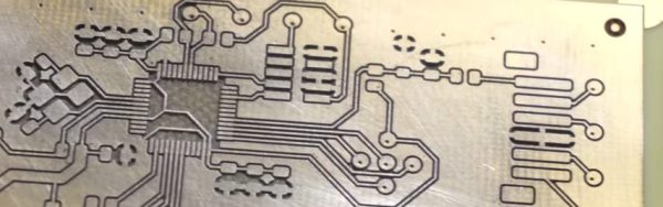

[Stephen Hawes] hit on the idea of buying a bulk set of PCBs from the usual vendors. The boards will be simple copper pours with vias in a grid with just a bit of etching. PCB Vendors are good at that, after all, and it’s not going to cost much more than raw copper. [Stephen] then uses the template of this “viagrid” board to lay out the circuit he’s prototyping, and it’s off to the races.
Or, off to the laser, rather. Unlike the fiber laser he showed us previously, [Stephen] is now recommending a diode-pumped solid state (DPSS) laser, as they can blast the copper off without burning FR4 substrate. Given that the vias are now part of the design, everything needs to line up perfectly, so his viagrid PCB design has a few features to lock it in using LightBurn’s “frame” feature. The DPSS laser barely shows up on the copper, but shines brilliantly off the fiberglass, and viagrid takes advantage of this fact. He’s also got a 3D printed jig to hold everything in alignment once it’s dialed in, even for running off many boards.
This laser is just as fast as the fiber laser, giving you PCBs in minutes. And while vias are apparently best left to the professionals, through-hole components can easily be accommodated, with the laser able to cut the FR4 on request. All of his lightburn and files for the varigrid PCB are available on GitHub. [Stephen] is also looking for collaborators to see if this technique can be used without the very-expensive Commarker laser, and to come up with a better name than viagrid.
As [Stephen] says in the video, if you combine this with a pick-and-place and a reflow oven, you can go from design to a working two-layer PCB in about 90 minutes, which is a very exciting prospect for engineering companies and maker-spaces alike. Words like “game-changing” get thrown around a lot, but this just might warrant it, at least for those who have a need for speed and can afford the tools.

  1. The beauty of this is now that he shared the idea literally anyone can make something using this. Also ripe for tweaks like a middle ground/power layer.
  2. This is very cool. I however do not know how I feel about having to own a high power laser to make a PCB at home. Plus templates are just…I don’t know feel weird. But then again, I haven’t made PCBs at home in years.
    Using this technique, you would be obviously locked into the stackup of the original templates, and the max number of vias present in the template. You can’t make anything too complex like HDI boards, or BGA parts which require precise soldermask (unless the laser can also burn away soldermask after you manually put it on?). Impedance controlled traces can be done since you know the stackup I guess, so low GHz ISM stuff is possible. Also no silkscreen, not a big deal

    2. Well nothing about this method actually requires the laser, you could still etch or mill the two sides if you wished to as the real trick is the via grid that lets you have that 2nd layer of complexity more easily.
    3. I don’t get the feeling that this is aimed at the home hobbiest, especially not at the prices for the laser. But for a business where time is literally money, being able to turn around prototypes in hours vs days can make this a compelling proposition. Very few are going to use this for very complex designs, but for quick confirmation that a part works as expected, or for debugging parts of a circuit, perhaps, I could see this being useful.
      And I do also think that the concept is the powerful thing – companies with different requirements will refine it for their needs – extra layers, more vias, some standardised footprints and breakouts (potentially on multiple layers) for common components, etc. Come up with your own template for the FPGA or whatever ICs you commonly build around, leave space for the unique requirements around it, and order a bunch at the beginning of the project. Those arrive in a week, while you are getting some initial schematics sorted out, and from there, you can iterate every two hours.

    1. Well, the above-mentioned viagrid in the article is open source, you could create your style of PCBs with JLC and try them that way.
  5. Funny. Literally yesterday I was thinking about breadboarding some RF circuitry, where I’ve already solved some sections (which can go down as proper footprints and layout), then pondering a hand-carved style proto area where I can trial the rest of it. Just some blank, sea of copper clad, area to work on. But at frequencies where manual vias would be a right pain; and, if it’s a fabbed board, I could get those for free, if only I knew where to put them. Hmm…
    The challenge, or tradeoff, is via spacing and pattern. It can’t be too tight or you can’t do anything with it; it can’t be too loose or you’ll run out of grounds (at RF: ground impedance and stub length). Is it better to have one pattern? Various? By region? Perhaps chaotic even?
