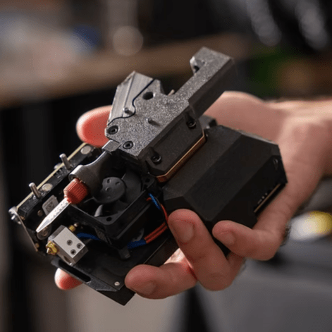

[Prusa] have a number of announcements, and one of the more unusual ones is that liquid printing is coming to the Prusa XL. Specifically, printing in real, heat-resistant silicone (not a silicone-like plastic) is made possible thanks to special filament and a special toolhead. It’s the result of a partnership with Filament2, and the same process could even be used to print with other liquids, including chocolate.
Look closely and you will see the detail in the nozzle, which mixes the two-part formula.
The process is as unusual as it is clever. The silicone is a two-part formula, but there is no reservoir or pump involved. Instead, there are two filaments, A and B. When mixed, they cure into solid silicone.
What is unusual is that these filaments have a liquid core. Upon entering the extruder, the outer sheath is cut away, and the inner liquid feeds into a mini mixing nozzle. The nozzle deposits the mixed silicone onto the print, where it cures. It isn’t clear from the demo where the stripped outer casing goes, but we assume it must get discarded or is possibly stowed temporarily until it can be removed.

  1. Neat idea, metering the two-part silicone by treating it like a filament. It remains to be seen whether this is better/easier/cleaner than a syringe/plunger based system, or even just a pair of small pumps drawing from a couple of bottles.
    With that mixing nozzle, it’s a lot like those super-fast-set epoxies dispensed from a dual syringe with the replaceable mixing nozzle. That piece is certainly a per-session consumable. And you’re not going to be able to loiter around not pushing goo for a while: it’s going to set up in the nozzle.
    It looks like the waste snakeskin is removed through that third fat tube. I wonder how often it gets clogged up with residual A & B components setting inside it. Betcha it’s a consumable too.
    1. Looks like an off the shelf mixing nozzle; they’re like 2$ each or so.
      The other benifit with silicone is it… doesn’t stick to things. I’ve literally been able to re-use mixing nozzles by pushing the core out and peeling off the cured silicone. Usually not worth the time for a 2$ nozzle, but it’s a lot more friendly to reusable hardware than epoxy.
      I do wonder how a pair of peristaltic pumps fron 2 bottles would perform; I don’t recall what the volumetric accuracy on those is. Keeps the resin contact to just the tubes, replace them if they get clogged. I wonder what the cost of the filament vs standard silicone resin is.

  2. They are not very clear about how this works, but @ 02:30 you can (barely) see that the split open parts of the filaments are going upwards. Going back, @00:02 you can see the cut open pieces are fed into a third plastic tube.
    But overall this looks like a way that is designed to extract as much money from the customer as possible, I have not looked up the cost of this filament, but I guess it’s on par with the USD 1000 printing head.
    And if you’re going to do a new printer head, then why not simply use syringes? Printers that use syringes have been used for things like solder paste and clay to chocolate and other cake decoration materials.

  4. Does anyone see two separate extruder motors? I can’t tell if it’s set to use the optimal ratio of the only filament available or if you can tune it to use different mixing ratios.
    Also, why is there still a brass nozzle and hotend on the toolhead? Maybe it’s a removable piece that attaches to an existing toolhead, or they’re just showing a working prototype or something.
