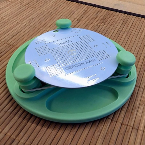

When it comes to soldering on a PCB it almost always helps to have some way to hold the board off your workbench, allowing leads to pass though with out making it unstable and keeping it level while working with tiny components. This project sent in by [Mel] was born out of necessity he was going to be teaching a soldering class and needed a way to keep boards in place, and so designed this Print-in-place PCB holder.
While there are certainly a long list of products designed to serve this function [Mel] took advantage of some idle 3D printers to turn out PCB stands that require no assembly, just the addition of a rubber band and they are ready for use. Part of the challenge of print in place 3D prints is dialing in the tolerances of your design and printer, and for this [Mel] printed some smaller slider mechanisms that were quick to print and iterate with until he was happy and could start turning out the larger design using those values.
The full PCB holder includes 3 independent sliders allowing for boards of all shapes and sizes to be held. To tension the board mounts there is a slow lower down on the uprights to allow for a rubber band to be added pulling all three towards the center. Finally [Mel] included small trays between the 3 sliders to give you a convenient place to components are you assemble your board. The 3D print falls are all available for download and [Mel] also included the small slider as a 3D print for you to check your printer tollerances before you run off the final design. Thanks [Mel] for sending in your soldering tool design, it’s a great addition to some of our other soldering assistant devices we’ve featured.

That’s a really clever use of print-in-place parts. You could make all kinds of clamps with a similar method

Must be ideal for hot-air reworks.
Yeah, and don’t solder a connection that will transfer heat through the board and melt the rubber band. It would be better to add some feet to the base, to raise it and allow the posts to extend below it to allow putting the rubber bands there.
It’s a safety feature. If you’re applying too much heat, it’ll fling the board across the room. The passing air cools it quickly and it’s usefully embedded into your vision board, waiting for you to retrieve. it.
I already have an old Helping Hands, with all the fiddly little clamps. I also have a rotisserie that holds the PCB and lets me turn it over when I need to access both sides. I also have a gizmo made of PCB arms that I saw here and ordered from JLC on a whim. I also make heavy use of a big blob of blu-tac or a clothes peg at times to hold a job steady while (de)soldering.
That said, I am tempted to print one of these things. In my experience there is no “one tool to rule them all” when it comes to holding a PCB steady while you do stuff to it with a hot iron. If you have the shelf space, there’s no harm in owning a few different options. Especially if it’s something like this which can be printed at home and customised to suit your needs.
