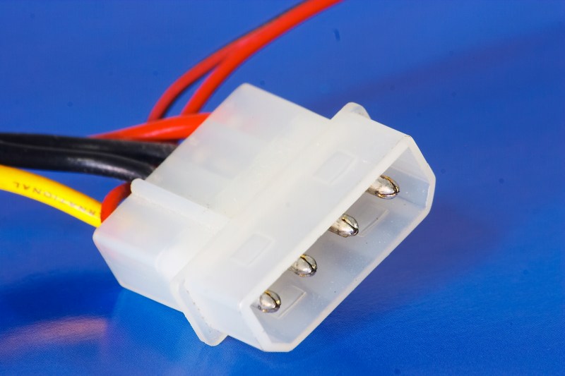

Nope. The “Molex” connector shown here is not a Molex-connector. It’s made by AMP (now TE connectivity) https://commons.wikimedia.org/wiki/File:Amp_and_Molex_Connectors.jpg
They’re all colloquially known as “Molex connectors”.
https://en.wikipedia.org/wiki/Molex_connector
