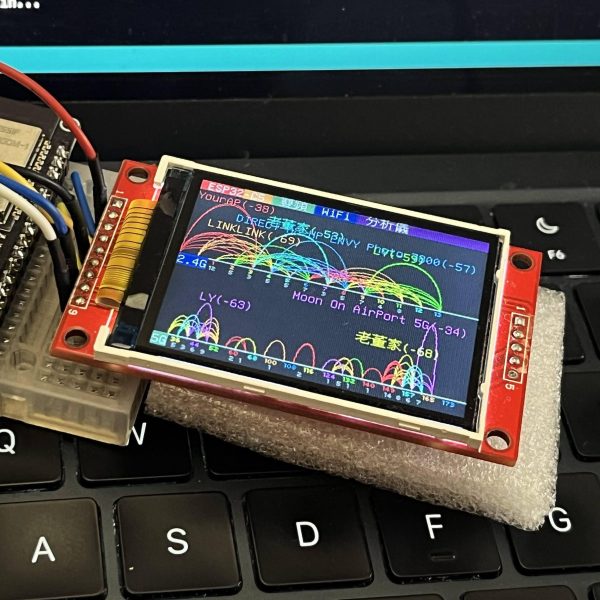

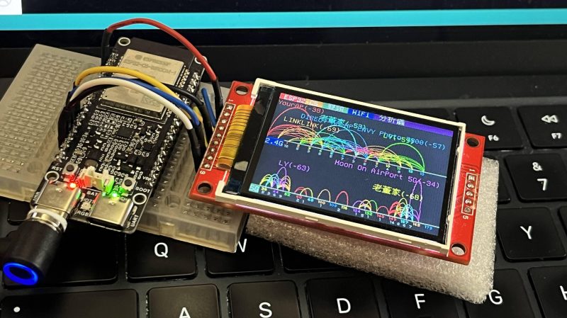

Wi-Fi! It’s everywhere, and yet you can’t really see it, by virtue of the technology relying on the transmission of electromagnetic waves outside the visual spectrum. Never mind, though, because you can always build yourself a Wi-Fi analyzer to get some insight into your radio surroundings, as demonstrated by [moononournation].
The core of the build is the ESP32-C5. The popular microcontroller is well-equipped for this task with its onboard dual-band Wi-Fi hardware, even if the stock antenna on most devboards is a little underwhelming. [moononournation] has paired this with a small rectangular LCD screen running the ILI9341 controller. The graphical interface is drawn with the aid of the Arduino_GFX library. It shows a graph of access points detected in the immediate area, as well as which channels they’re using and their apparent signal strength.

    1. All these apps and pet projects always do the same: do a WiFi scan and print results in a graph based on RSSI. But it would be so much better printing also channel load. Many times it’s better using an AP with lower RSSI, but on a less congested channel.
      I suspect channel load might be tricky (if even possible) to get on smartphones (the usual implementation requires monitor mode), but it is completely possible doing it on an ESP32 (I have done it for the 2.4 GHz band).
