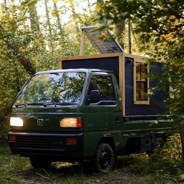

A forest green kei truck sits in an actual forest. In its bed is a dark grey box with a small window, wood trim, and a solar panel tilted on its roof. The headlights are on, hinting at the onset of twilight. You have a sudden urge to go glamping now.
Tent camping lets you explore places on foot you could never reach another way, but sometimes you want to camp with a bit more luxury. [Levi Kelly] decided to see how small you could make an RV. [via Autopian]
While we won’t argue one way or another on his claim to world’s smallest, as that likely depends on your definition of an RV, starting with a kei truck certainly puts you in a more compact format than something built on a bus chassis. With four wheel drive and a small footprint, this could be better for overlanding than the Rivian bed camper we featured recently.
The 21 sq. ft. (1.95 m2) camper portion itself is framed in 2 x 2s (38 x 38 mm) to save weight and uses foam board insulation. A working faucet uses a pump to draw drinking water from a 5 gallon (19L) refillable jug and empties into a 7 gallon (26L) grey water tank. A solar panel on the roof charges the battery that drives the pump, ventilation fan, and can also be used to run other devices like a hot plate for cooking.
A teeny tiny wood stove can be used for heat, although [Kelly] is using a different fuel source to reduce unpredictability from a wood fire in such a small space. A faucet-mounted sprayer can be routed to the outside of the camper to create a makeshift shower and is run from the sink water system. There’s even a small cabinet above the foot area of the bed to house a portable toilet and a bubble window to observe your surroundings while you do your business.

  3. I like the overall concept of a minimalist tiny RV, and I think he did a pretty good job. I would absolutely build and use something like this if I had the spare time and funds to do so.
    My biggest dislike of his approach is the toilet setup. Looks fine when empty. Suspending a unit with waste in it above my sleeping area? No thank you.
    If I were to make this I’d go just a bit taller, maybe another 6″ should be doable without getting unstable, raise the bed platform, and get a smaller toilet that can go under the bed, or even get stored outside.
    I also echo some of the comments on the video, he could have extended the camper portion over the truck cab and added some storage that way.
  4. That’s the result of the Youtube rat race. People make things to look good, without any consideration for any low level stuff like safety, usability, comfort, and reproducibility. You can’t have a “camper” on a truck without a secure attachment. Just imagine this truck being hit by the side (or if it had to roll a bit on its side), the whole “house” will simply roll over.
    A fuel stove without any gas exhaust is a dead trap. Look, even inside the advertisement, the flames were already higher than expected and started to heat the roof.
    There’s no reason for the house to be so low (except because it cost more to use longer stick), and only cause burden inside (he had to add a “bubble” window after realizing his mistakes). He could never sleep in this camper, since any movement of his legs would hit the sharp corner closet above. If instead he add 1 feet higher, the toilet would have fit under the bed.
    There is no way the cell built this way could be water and weather proof. So, you can’t park this vehicle outside and even if you keep it inside, you can’t use it (same issue, you don’t want to have a fire and fumes inside a building).
    I’m pretty sure the vehicle isn’t even allowed on the roads (that’s why it’s only show in his garden).
    So, yes, anyone with few hand tools can make a cube/box and anyone can stuff things into it. But there’s a difference between a toy camper like this and a real vehicle.
