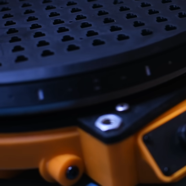

Sometimes the simplest objects need some overthinking. This is exactly what [Chris Borge] realized when using his 3D scanner and finding that the included rotation table left quite a bit to be desired — providing him the perfect excuse to build a new one.
One of the main features of a rotation stage is the, well, rotation. This was done in [Chris]’s case with a NEMA 17 stepper motor, perfect for precise rotation of scanning. Hooking up the motor to a basic perf board with an Arduino Nano allows for on the fly adjustments to rotation speed. To really solidify the over-engineering, [Chris] applies his obligatory concrete mix to add some heft to the stage.
While the previous features could be removed/downgraded without much loss, the adjustable grid built into the top adds significant functionality. The grid is based on [Chris]’s past projects, which allows cross compatibility.

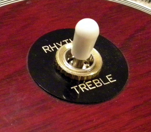

      1. You put a nut and washer on the switch, leaving just enough thread for the panel and another washer nut (plus optional washer, plate whatever). Push switch thru panel, put second nut on. Adjust rear nut if needed to set switch height.
        It should look like this: https://www.premierguitar.com/media-library/photo-1.jpg?id=25745645
        As the picture shows you can get fancy nuts for the outside, but inside will be the usual boring nut.
        The switch shouldn’t rotate when you tighten the nut because you’ve remembered the key (no you didn’t and the punch is expensive so you just drilled a hole) or you figured you what that funny washer with the tab poking up is for (key lock washer).
    1. To be fair, the correct way to mount them is not blatantly obvious, but the inclusion of a ‘spare’ nut should be a clue.
      Maybe they simply have not seen how to use the second nut. Or glanced at a proper datasheet for the part.
      So, you going to make a tutorial to show the unwashed the Correct Way?
      1. I would genuinely appreciate a tutorial video or even a series of HaD articles about these kinds of finishing touches. Panel mounting, using the right types of washers, etc.
      2. To be fair every datasheet I’ve ever seen shows it wrong. It seems to one of those things that is never written down but you learn from some old dude one day. Like “clocking” screws, although that’s a bit more well known.
