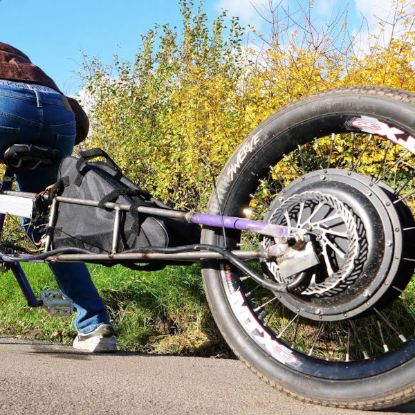

The project began as a fun weekend project for friends [Sam Barker] and [Tom Stanton]. They had a 20″ BMX wheel with a massive integrated hub motor that seemed to be begging to be put onto a BMX bike that they had on hand. After hooking up a 72V, 20Ah battery to it they were quickly zipping around the driveway, but the short wheelbase on the bike was bottlenecking its maximum performace because the bike would wheelie under high throttle. To solve that, they broke out the welder and extended frame, which kept the wheelies to a minimum and allowed them to take it out and drag race.
Another benefit to the extended frame is that the bike has room to store its battery now as well; before the frame extension it was strapped to the side of the frame under the rider in a non-ergonomic fashion. The duo also had to figure out a braking solution since the BMX didn’t come with its own brakes, but a loaner caliper from a penny farthing was found for some basic stopping abilities. We might assume this bike is not street legal on many public roads, but not every ebike operates in the same legal jurisdictions you might be the most familiar with.
