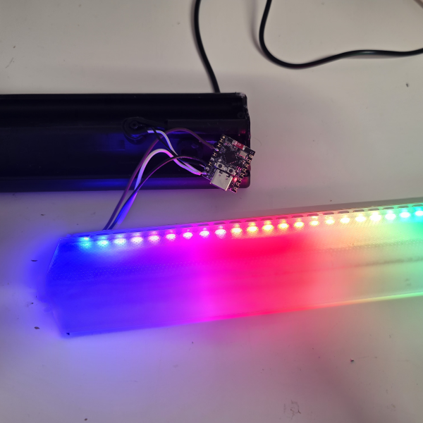

To do this, the control board of the lamp gets replaced with an ESP32-C3 Super Mini board. Control and automation comes from WLED, open-source software that offers flexible automation and control for LED lights with a wide range of features, including native Android and iOS apps.
Modifying the SKAFTSÄRV lamp is fairly straightforward, but opening the unit does require breaking some glued seams to get inside. Once that’s done, the replacement board fits nicely into the housing and the unit can be closed back up. As far as WLED is concerned, the new lamp has 30 LEDs, WS281x type, GRB color order.
The end result is a stylish accent lamp with built-in diffusor and mount that can be controlled over WiFi with all the features WLED brings, such as easy integration with Home Assistant.

  5. Thanks for this article. I followed the instructions on the Github page, ordered the ESP32 boards and converted 3 of these.
    Programming the ESPs with WLED was easy via webserial (directly downloading the firmware and pushing it into the controllers, one by one in the browser).
    Overall it was pretty easy. One of the hardest parts was carefully breaking the glue loose on the outer cover, but I got it done eventually.
    The other tricky part is that you have to solder two wires to both the +5 and the ground pads, and the pads are tiny. I was able to grip the sets of two wires with hemostats squeeze them together, then solder them both on as if they were one. It helped a lot that I have a tiny Pinecil soldering iron that has very precise temp control and a tiny tip.
    All three of the units are converted and operating. I’m going to control them all via Home Assistant, but you could control them with the WLED web interface itself just fine.

    2. Several guitar picks, spudgers, tweezers and a few flat head bits later, and, I am left having to ask: Do you have more details on actually breaking the glue without breaking the plastic? All I seem to get to do is chip off bits of the seams.
      1. The biggest tip I have for that is, start in the middle (try each side of the middle for a place to start a gap). Put something like a really thin guitar pick (or better yet, one of those phone disassembly toolkit tools, the thinner, the better) and very slowly work toward the ends, where the glue actually is.
