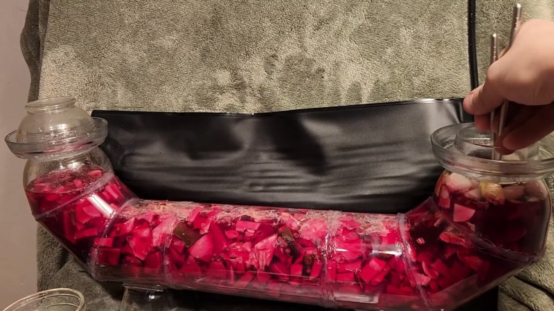

Home-fermented foods are great– they’re healthier, more flavourful, and cheaper than store-bought alternatives. What they aren’t is convenient: you need to prep a big batch of veggies, let it sit, and then you have to store the excess pickles. If you’re not careful, you end up with ancient, over-fermented pickles at the bottom of the crock, or worse– run out of pickles! Surely a fate worse than death. [Cody] at Cody’s Lab has a solution: a continous-flow fermentation process that keeps just the right supply of pickles coming at all times. Our grandmothers who kept a crock for months in the cold room or root cellar might be confused, but this hack brings pickles into the Just-In-Time framework of the 21st century.

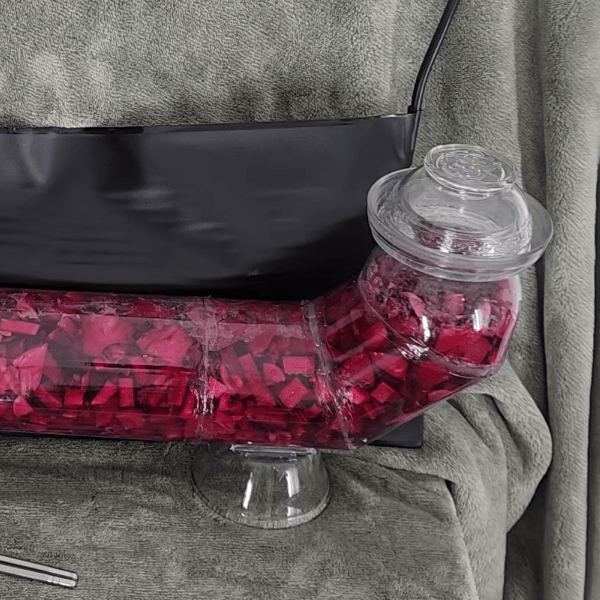

Specifically this is for lactic acid fermentation, the type that gets you kosher dills, saurkraut and kimchi along with a whole mess of other tangy, tasty vegetable treats. Vinegar pickles are a whole other thing. It’s done in a brine, as the lactic acid bacteria are salt tolerant in a way that most things that would rot your food and/or make you sick would not. You can reuse the brine over and over, which is what [Cody] is doing: he crafts a U-shaped crock out of old glass bottles and a couple of pickle jars. He cuts the jars into angled pipe segments that are held together with aquarium sealant, which is apparently food safe. It holds water and looks surprisingly good, in that it isn’t hideous.
The bioreactor gets loaded up with veggies on one end, plus lots of salt and spices to taste, plus some cultured brine from an old batch to kickstart everything. The starter isn’t necessary; it just gets things going faster. The initial packing is the hardest: after filling it the first time, one needs only press new veggies in at one end, while removing tasty treats at the other. A special packing tool [Cody]makes helps with that, but he plans on adding a larger feed side. Thanks to that kickstart, the pickles were ready to try after about a week– which means his tube is a bit long, for his desired dwell time. If you like more fermentation to your pickles, then you might like this size.

  1. This is special and practical. I wonder if they have plans to add more flavor. Like dill, peppercorns, and grape leaves. Or maybe that ruins everything. I want one of these though, assuming I don’t contaminate the whole tube with something less ideal
  2. I love it. It is a great setup. There are commercial setups used in industry for this, apparently, but this is a home practical setup.
    THough I can’t stop thinking that it is, in essence, my colon.
  3. Blech… no they aren’t ‘more flavorful’ just differently flavored, and typically not in a good way. And even if you have a favorite recipe this is a terrible way to go about it. Dilute the whole thing too much and you can eventually get mold growing which spoils the whole batch from end to end. So then you’re stuck adding small amounts of pickling spice to keep the concentration up as you remove it. Consume them too quickly and you start getting underdone ones, too slowly, why bother. The device is also awkwardly shaped for storage. Just utilize as many jars as you have need for to do the batch you have and you never run into any of these problems.

  4. The goal was a perpetual pickled vegetable machine, a long batch where each addition alters the next pickle. This allows the reuse of the prior ferment anaerobic which is useful.
    Ideally you would only use leftover scrap vegetables to feed it regularly. I could easily see 3-4 with different ferments based on what you wanted for the outcome.
  5. It won’t look as pretty, but this could be easily achieved using some stainless steel tri-clamp fittings – a couple of 90 degree bends and a straight section. Sight glasses are available so you can see how your pickles are pickling, but they cost a bit more
    1. You can’t properly pickle in steel. You need plastic, ceramic or glass. When the metal lid that closes your jars is scratched and has some metal exposed inside, typically whole jar is gone, some kind of bad bacteria eats your pickles instead of just pickling them. I don’t exactly know what happens but have seen it many times. And those bacteria will definitely attack stainless. Or chrome from steel will attack the bacteria.
      1. Jam jar lids are mild steel, which will definitely corrose. I mean 304 or 316, food grade stainless steel. This is the standard material for the majority of all food processing, including acidic foods, and fermentation (brewing, pickling, etc) . Assuming all welds are done properly and it is properly passivated (which is done using either nitric acid, or citric acid) then it’s going to be chemically inert unless the chromium oxide layer is disturbed, but that requires a very strong acid (concentrated hydrochloric for example), or mechanical damage.

  9. Essentially, this is equivalent to having enough jars to cover the fermentation time and the weekly consumption, and reusing the same jars and liquid once they are empty, with the disadvantage that if something goes wrong the whole batch is ruined. Additionally I wouldn’t trust the aquarium glue to be pickle safe.

  10. I wonder if you could build this pickle reactor (oh, that’s a good name) from ceramic pipe or maybe even, if you’re a potter, make a whole ceramic one?
    1. As long as you’ve got a safe glaze on it, I don’t see why not!
      I’ve seen antique pickling crocks of all shapes and sizes, but they all seem to have been glazed.
