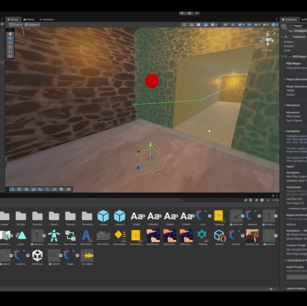

The Unity game development platform was first released in 2005, long after the PlayStation had ceased to be a relevant part of the console market. And yet, you could use Unity to develop for the platform, if you so desire, thanks to the efforts of [Bandwidth] and the team behind psxsplash.
Yes, it really is possible to design games for the original PlayStation using Unity and Lua. Using a tool called SplashEdit, you can whip up scenes, handle scripting, loading screens, create UIs, and do all the other little bits required to lash a game together. You can then run your creation via the psxsplash engine, deploying to emulator or even real hardware with a single click. Currently, development requires a Windows or Linux machine and Unity 6000.0+, but other than that, it’s pretty straightforward to start making games with a modern toolset for one of the most popular consoles of all time. Just remember, you’ve only got 33 MHz and 2MB of RAM to play with.
