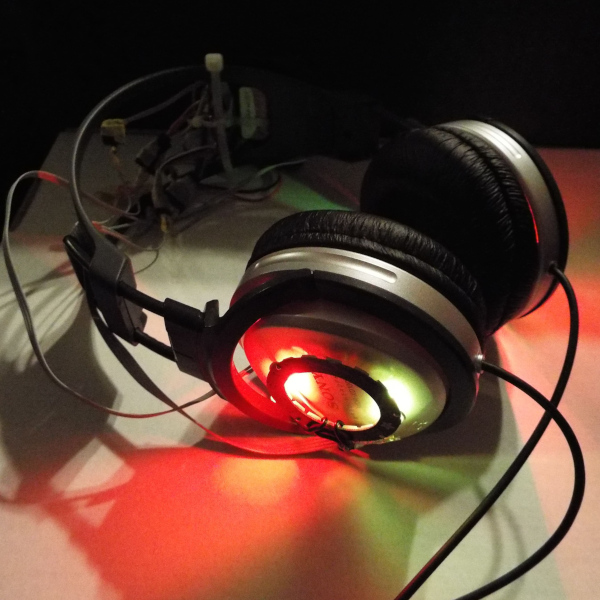

Noise cancelling headphones are a great way to insulate yourself from the bustle of the city, but due to their power requirements, continuous use means frequent recharging. [Alessandro Sgarzi] has an elegant and unique solution — powering the noise cancelling electronics by harvesting energy from the ambient noise of the city via a sheet of piezoelectric film.
This impressive feat is achieved using a LTC3588-1 power harvesting IC and a pair of supercapacitors, while an STM32L011K4T6 microcontroller processes the input from a MEMS microphone and feeds a low-power class D amplifier. This circuit consumes an astounding 1.7 nW, a power that a noisy city is amply able to supply. Audio meanwhile comes via a traditional 3.5 mm connector, which we are told is the cool kids’ choice nowadays anyway.

    1. 17nW for a MEMS a µC and a Class-D Amplifier still sounds unlikely to me:
      You need a good headphone to even hear a 17nW audio-signal at a comfortable level.

  1. “Completed project” with no files, and the maths are very dubious. And the thing has no noise cancelling feature are stated in the article. Smells like slop of slop.

  3. So I read the project and have to assume mono sound able to be drowned out by the sounds that power it?
    This film seems fake. $cm, what kinda unit? What voltage? Could be speaker materiel itself possibly, more likely noise maker.

  5. According to the creators comments on their project page, noise cancelling is not yet implemented. These appear to be just an amplifier stage for the headphones. Looking forward to seeing a schematic, code and or some other details from the creator.
    1. Oh, so this is running the amplifier? I was wondering what its doing if the noise canceling isn’t implemented yet. Cause I have headphones with no microcontroller nor any other power consuming parts besides the drivers that get powered by the ghost input power from the 3.5″ plug. I’d recommend some of the soft foam earphone caps. They cancel noise and don’t require engineering nor powering.

  9. This sounds implausible. Sure, maybe you can power up the chips on 17 nW (though the PAM8302A listed consumes 3000 nW already in shutdown mode).
    But getting any useful amount of audio power from the speaker elements? Nope, not happening.
  10. The purpose of this project is not entirely clear and raises several questions. In the absence of a noise-cancelling function, and with audio provided via a 3.5 mm jack, it is unclear what role the STM32L011K4T6 microcontroller and the MEMS microphone are intended to fulfil. Additionally, the source of power for the LEDs (definitely beyond nW-scale) is not specified. As it stands, the technical explanation appears incomplete.
