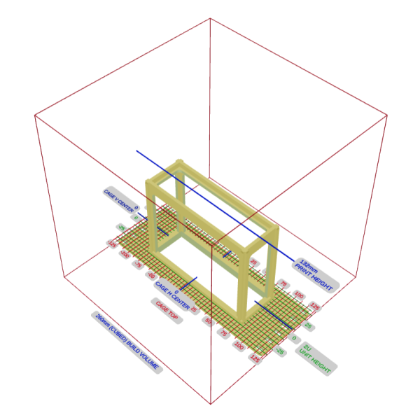

Sometimes, as hackers and makers, we can end up with messy lashed-together gear that is neither reliable nor tidy. Rackmounting your stuff can be a great way to improve the robustness and liveability of your setup. If you find this appealing, you might like CageMaker by [WebMaka].
This parametric OpenSCAD script can generate mounts for all kinds of stuff. Maybe you have a little network switch that’s just a tangle of wires on your desk, or a few pieces of audio gear that are loosely stacked on top of each other and looking rather unkempt. It would be trivial with this tool to create some 3D printed adapters to get all that stuff laced up nice and neat in a rack instead.
If you’re eager to get tinkering, you can try out the browser-based version quite easily. We’ve featured similar work before, too—many a maker has trod the path of rackmounting, as it turns out.

  4. Being an OpenSCAD bigot myself, I tried it out briefly and my observation was that whilst it seems extraordinarily capable, it doesn’t seem to have a notion of Rack Units (1 RU = 1.75″) which is the standard rack height dimension.
    Well I didn’t see such a thing under the Rack Geometry customiser or Device Height, only a whatever-you-like metric height value. I searched the code and no ‘rack unit’ or variations thereof. Also it seems pure metric which is ok for me but there are some countries in the world whose residents that may not feel quite as enamoured.
    A suggestion I can think of is that there are so many options available that a series of pairs of small screenshots as numbered Figs (and the customiser texts mentioning which Fig) showing the before/after effect of a setting would be useful, much like the OpenSCAD guide itself. The QuckStart Guide doesn’t give a lot of help but pushes you onto an ‘OpenSCAD Playground’ thing which I didn’t bother checking out.
    1. The choices of rack geometry are defined on lines 513 and following; the unit height is specified as 44.45 mm, equal to 1.75″, for EIA-310 and its variants. Obviously the non-standard options (20mm, 25mm, etc.) specify their respective non-standard unit heights instead.
      It determines how many units tall to make the cage based on the size of cage needed. So if the device height + cage floor & ceiling adds up to between 1.75″ and 3.5″, for instance, it spits out a 2U cage.
      As for demonstrations of each option, the github wiki has a ConfigOptions page that seems close to what you’re looking for.

  5. The EIA-310 modes all assume a standard rack height of 1.75″/44.45mm, and cage height is automatically scaled based on device height plus the support structure that contains the device, which adds 14mm by default. Non-EIA-310 modes will use the height listed. I can add the heights for EIA-310 to the customizer but I suspect that anyone that knows what EIA-310 even is probably already knows this detail.
    The rack geometry parameters are listed in the code along with an explanation of how the array is structured starting on line 512.
    Also, the ConfigOptions page in the wiki has explanations of every option along with screenshots of what they do.
