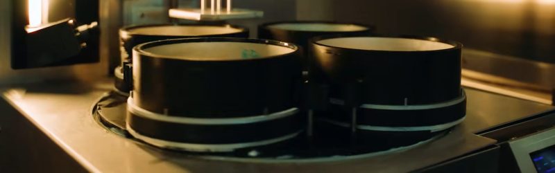

The technique is simple: instead of one resin tank underneath the dipping build plate, [Eric]’s Polysynth printer has a carousel of up to eight small circular tanks. To avoid cross-contamination from uncured resin, the print needs to be cleansed between alternating dips in the different resin vats. Rather than add a wash vat and slow the process down that way, [Eric] and his team decided to use centrifugal force: they just spin the print really, really fast to fling all the uncured resin to the sides of the vat. Yes, really.

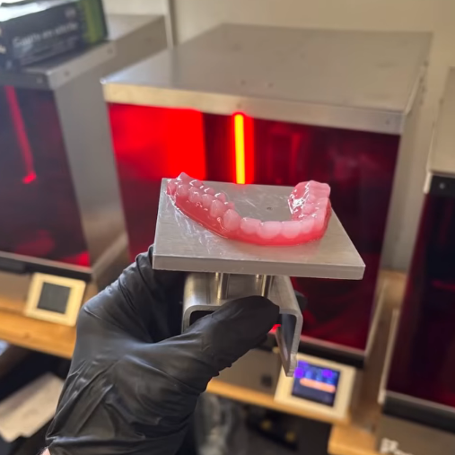

The hard part isn’t the resin-removing spin cycle — the hard part is stopping the spin at the precise orientation the part started at, to within a few microns. For that, he’s using a sort of kinematic linkage to lock the spinning portion back into place using a servo. It seems to work, based on the demonstration in the video embedded below. Even better, [Eric] shows off a resin conductive enough to use for fully printed, multilayer PCBs. We doubt SLS will ever compete with traditional fabs on volume, but for fast turnaround without waiting on parts from China, the conductive resins could open up some killer apps for this kind of printer. That and dental: printing gums and teeth of dentures in one solid go is likely to appeal to users in that space.
