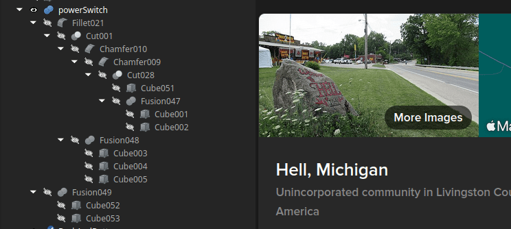

Name Your Bodies, Always
The button is F2. That’s it. Click on your models in the tree view and give them a name. Do it for all extrudes, cuts, and even fillets/chamfers. You don’t have to do it for sketches, since those are always contained within an extrusion. If at all possible, do it immediately, make it a habit.
Why? Because names make it clear what the extrusion/cut/fillet is for, and you’ll be thankful for it multiple times over when modifying your model or even just looking at it the next morning. Also, it makes it way easier to avoid accidentally sending the wrong 3D model to your printer.
They’re the same picture.
How to make naming easier? I’ve figured out an easy and apt naming scheme, that you’ve seen in action in the previous article. For Fusions, I do “primary object +addition” or “with addition”, mentioning just the last addition. So, “Bottom case +cutouts” is a cut that contains “Bottom case +logo” and “Cutouts”, “Bottom case +logo” is a cut that contains “Bottom case” and “Logo”, and “Bottom case” contains “Bottom floor” and “Bottom walls”.
It’s not a perfect scheme, but it avoids verbosity and you have to barely think of the names. Don’t shy away from using words like “pip” and “doohickey” if the word just doesn’t come to your mind at the moment – you’re choosing between a project that’s vaguely endearing and one that’s incomprehensible, so the choice is obvious. Naming your models lets you avoid them becoming arcane magic, which might sound fun at a glance until you realize there’s already an object of arcane magic in your house, it’s called a “3D printer”, and you’ve had enough arcane magic in your life.
Last but not least, to hack something is know learn its true name, and whatever your feature is, there’s no truth in “Cut034”. By the way, about FreeCAD and many CAD packages before it, they’ve been having a problem with true names, actually, it’s a whole thing called Topological Naming Problem.

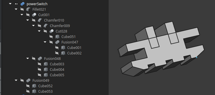

Naming Is Hard, Topology Is Harder
How do you know where a feature really is? For instance, you take a cube, and you cut two slots into the same side. How does the CAD package ensure that the slots are on the same side? One of the most popular options for it is topological naming. So, a cube gets its faces named Face1 through Face6, and as you slowly turn that cube into, say, a Minecraft-style hand showing a middle finger, each sketch remembers the name of the side you wanted it attached to.
Now, imagine the middle finger hand requires a hole inside of it, and it has to be done at from very start, which means you might need to go back to the base cube and add that hole. All of a sudden, there will be four new faces to the internal cube that holds the finger sketches, and these new faces will need names, too. Best case, they’ll be named Face7 through Face10 – but that’s a best case and the CAD engine needs to ensure to always implement it properly, whereas real world models aren’t as welcoming. Worst case, the faces will be renumbered anew, the sketch-to-face mapping will change which faces get which names, and the model of the hand will turn into a spider. Spooky!
It’s not Halloween just yet, and most regretfully, people don’t tend to appreciate spiders in unexpected places. Even more sadly, this retrospective renaming typically just results in your sketches breaking in a “red exclamation mark” way, since it’s not just sketch-to-face mappings that get names, it’s also all the little bits of external geometry that you’ll definitely invoke if you want to avoid suffering. Every line in your sketch has an invisible name and a number, and external geometry lines will store – otherwise, they couldn’t get updated when you change the base model under their feet, as one inevitably does.

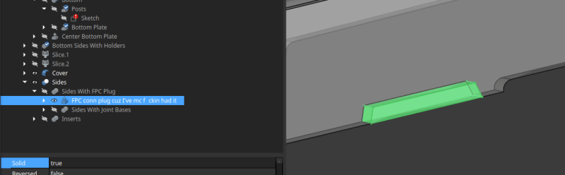

Before FreeCAD v1.0, I sometimes had to make “plug” solids instead of removing cutouts. Nowadays, I have to do that way less often.
This used to be a big problem with FreeCAD, and it still kind of is, but it’s by no means exclusive to FreeCAD. Hell, I remember dealing with something similar back when my CAD (computer-aided despair) suite of choice was SolidWorks. It’s not an easy problem to solve, because of the innumerable ways you can create and then modify a 3D object; every time you think you’ll have figured out a solution to the horrors, your users will come up with new and more intricate horrors beyond your comprehension.
FreeCAD v1.0 has clamped down on a large amount of topological naming errors. They still exist; one simple way I can trigger it is to make a cutout in a cube, make a sketch that external-geometry-exports the cut-in-half outwards-facing line of the cube, and then go back and delete the cutout. It makes sense that it happens, but oh do I wish it didn’t, and it makes for unfun sketch fixing sessions.

The first solution concerns cutouts, as they specifically might become the bane of your model. If you have a ton of features planned, just delay doing the cutouts up until you’ve done all the basics of the case that you might ever want to rely on. Cutouts might and often will change, and if your board changes connector or button positions, you want to be able to remake them without ever touching the rest of the sketch. So, build up most of your model, and closer to the end, do the case cutouts, so that external geometry can rely on walls and sides that will never change.
Next, minimize the number of models you’re dealing with, so that you have less places where external geometry has to be involved. If you need to make a block with a hole all the way through, do it in one sketch instead of doing two extrudes and a cut. You’ll thank yourself, both because you’ll have less opportunity for topo naming errors, but also because you have fewer model names to think up.
In case you wondered what the “bad naming” example was about, it’s from this part. It’s a perfectly fine part because no external geometry relies on it in practice, but it’s also absolutely a good example of a part you can instead do in a single sketch-extrude and a (not shown) fillet.
