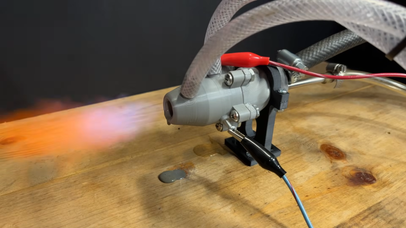

Consumer-grade 3D printers are useful for lots of things, but they kind of fall down when it comes to making stuff that survives high temperatures. [Mr. More Gooder] wasn’t deterred from a rocket build using FDM printed parts though, instead relying on water cooling to try and beat this practical limit.

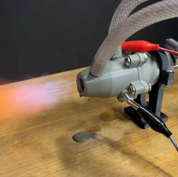

The concept is simple enough—[Mr. More Gooder] printed a propane-burning combustion chamber and nozzle out of plastic that you’d totally expect to melt when the flames started. Thus, the nozzle was given fittings to allow water to be continually pumped through to try and drag away enough heat to let the rocket survive more than a few seconds. Unfortunately, during testing the uncooled combustion chamber quickly melted. A redesign with water cooling throughout performed a little better, until the water jacket began to leak into the main chamber and extinguished the flames. Melted plastic could be seen dripping out of the nozzle shortly after ignition, too.
Even if the nozzle did hold up for a longer period of time, it’s worth noting this is probably not a viable route towards a flight-ready engine. Mostly because you would need a huge supply of water to keep the components cool which would add a great deal of weight to any such build. There’s a reason NASA doesn’t recycle old drink bottles to make rocket engines, after all.

    1. My understanding is that using the fuel as coolant(worst case it’s going to be roughly room temperature; best case cryogenic) is downright common and implemented on at least a crude level right back to the V-2; but has a lot of fiddly details just because of the fundamental tension between wanting basically the thinnest combustion chamber lining possible for low delta T and good cooling; but needing an actually mechanically sturdy combustion chamber lining with correspondingly worse delta T to survive the mechanical demands of running at relatively high pressure. Plus all the fun of different parts of the system heating up to different degrees and being cooled more or less effectively and the resulting thermal stresses.
      I suspect that plastic is a hard sell just because it combines a low melting point with relatively poor thermal conductivity, so the inside of the combustion chamber is absolutely going to be sacrificial unless you manage some really clever high pressure injection approach where there’s some sort of laminar flow of cold fuel protecting the walls of the combustion chamber from the combustion(ideally without losing too much of the protective fuel straight out the back); but if you only need a short burn regenerative cooling with the fuel could, absolutely, keep the entire engine from reaching heat deflection temperature and deforming wildly; and instead have it shed the inner wall of the combustion chamber at a relatively stable and manageable rate.
    2. Both of those things — running coolant through a jacket between two walls and spraying it against the inner wall — are used in real rocket engines. The difference is that they use fuel instead of water. Nearly all large engines run fuel through the engine walls as coolant before burning it, and quite a lot spray some in around hot spots to provide evaporative cooling and a film of non-combusting gas between the flame and the metal.
      This only fails because the plastic’s thermal conductivity is far too low. The heat flux that needs to be conducted from the inner surface to the coolant is massive, and a layer of plastic thin enough to keep its inner surface below the melting point while carrying that much heat is too thin to have any strength.
