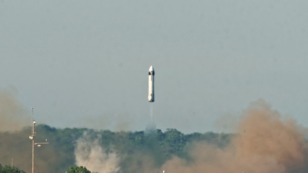

Australia’s Space Program Finally Gets Off The Pad, But Only Barely
Australia is known for great beaches, top-tier coffee, and a laidback approach to life that really doesn’t square with all the rules and regulations that exist Down Under. What it isn’t known for is being a spacefaring nation.
As it stands, a startup called Gilmour Space has been making great efforts to give Australia the orbital launch capability it’s never had. After numerous hurdles and delays, the company finally got their rocket off the launch pad. Unfortunately, it just didn’t get much farther than that.
Continue reading “Australia’s Space Program Finally Gets Off The Pad, But Only Barely” →
