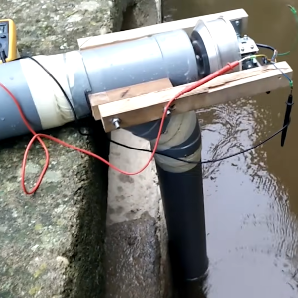

The build aims to use easy-to-find materials and simple tools. It uses 110mm and 160mm PVC pipe to not only siphon water up and over a dam, but to house the turbine as well. The turbine is built from a computer fan and sits inside the pipe with a shaft running through a Y-type fitting to the generator. The generator is built from a scavenged hoverboard wheel, and outputs a reported 3.3A DC at 60V for around 200 watts of power with only around 3m of head. The design allows the turbine to be placed at the point in the pipe that best suits the environment.
[OpenSourceLowTech], the creators of this project, make a compelling case that this build is cheaper than a 150W solar panel and it might even be able to produce more energy as well over certain timeframes, provided there’s a reliable source of water available and the owners of the dam don’t mind someone siphoning water over it continuously. The build video is worth a watch as well if for nothing else than the animation, which documents the build in excellent detail. Generating usable energy from hydropower doesn’t even need this big of a dam; if all you need is to charge your phone this tiny waterwheel will get the job done.

  4. Without mentioning the amount of water going through this, nothing can be said about efficiency.
    But 3 meters is enough to get some real usable power. For example the link below squeezes 28kW out of a head of just 2.5 meter.

    1. It’s constant, so that’s over 4.6 kW/h per day which is equivalent to between 3 and 5 solar panels depending on where you are. Nothing to sniff at
    2. “this build is cheaper than a 150W solar panel ”
      hydropower is generally continuous.. 192W of hydropower is the equivelent of 750w-1kw of solar panels.
      So it might not be niagra but Its enough to keep a houseful of LED bulbs lit, your phone charged, and if you buffer the power with a battery bank, you can probably cook a meal in the airfryer too.
      1. Might be more the, I have all these power sources around me, type of utilization. Who knows? Maybe next week is backyard geothermal, or harness the vibrations from the road in front?
      2. 192W of hydropower is the equivelent of 750w-1kw of solar panels.
        That’s optimistic. Residential scale solar usually doesn’t get that high of a capacity factor. 750 Watts you could expect from a utility scale solar farm in southern California. The residential setup would probably be 1 kW.
        If you’re not living in southern California, things get a whole lot worse. If you’re up in France, Germany or Poland, you can easily expect to install 2 kW for 200 Watt average output because of the higher latitude and cloudier climate.
