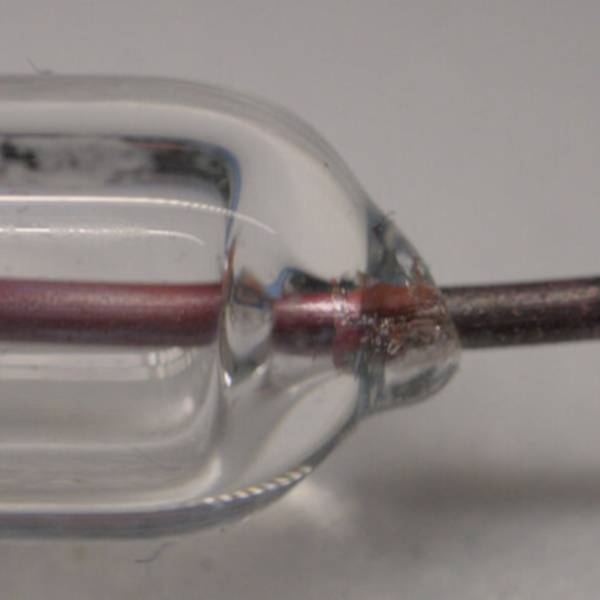

If you’ve ever taken a close look at a vacuum tube, you’ll have seen the seals around the pins that keep everything air-tight while providing the the device’s electrical contacts. As [maurycyz] finds out, it’s not an easy process to get right.
The problem is one of both chemistry and thermal expansion, as while a good seal can be made between glass and red copper oxide, it remains very difficult indeed to stop the glass cracking on cooldown due to differing thermal expansion properties. We’re led through a variety of experiments including surface treatments and flattening the metal to a sheet, with varying pros and cons. The most successful seal on the page comes from very thin tungsten wire, though hardly the most practical conductor for a vacuum tube.

    Dumet Wire: The industry standard for decades. It consists of a nickel-iron core (often a 42% nickel / 58% iron alloy) clad in a copper sheath. The copper creates a strong hermetic bond with the glass.
    Platinum: Used in early vacuum tubes (pre-1915). It expands and contracts at almost the exact same rate as soda-lime glass and bonds well to it (it would be an expensive option though!)
    Kovar: An alloy of iron, nickel, and cobalt specifically engineered for glass-to-metal seals. It is widely used with borosilicate glass in heavier-duty or power tubes

      1. Iron/nickel alloys have a sharp drop in coefficient of expansion to a minimum at 64/46 – at the lowest point it’s called invar. But that sharp drop allows you to find expansions over a wide range of values to match it.
        Dumet is basically the cheap version, because the copper oxide bonds well and the core provides the CTE match, and the copper can handle the stress across the boundary so long as the wire isn’t that big.
    2. Dumet/kovar are basically derivatives of invar, which is the iron/nickel alloy at basically the minimum thermal expansion of the two combinations. Won the Nobel Prize for its discovery and is stupid useful. We always called the leads through PMTs invar because we were lazy. (It’s still where almost all of the cracks started).
      They’re derivatives because you don’t want zero thermal expansion, you want to match glass, so you move slightly off the minimum around 36% nickel to match it.

  3. This problem was solved generations ago by Kovar family alloys. See the book “Laboratory Scientific Glassblowing” by Paul Pinnet, that’s the bible behind the explanations. The key is wetting prep and the right coefficient of thermal expansion matching material to the glass.
    1. Handbook of Electron Tube and Vacuum Techniques by Fred Rosebury. Published in 1965. Still near the state of the art, because most all of this field was bypassed by transistors. Large tables of coefficients of thermal expansion for both glasses and metals. Also techniques for how to make the seals, with additional geometries other than wire-through-wall.
      I have a paper copy. It’s full of great stuff, including how to do hydrogen brazing (reducing atmosphere), which is how you built high-vacuum fittings before e-beam and laser welding was a thing, and remains totally accessible to a serious garage hacker.
  4. The trick for tungsten wire is you need to oxidize it before you coat it in glass. You heat it in a flame to get it hot to oxidize and you are looking for “Kentucky fried Chicken brown”, as the glassblower I learned from called it.
