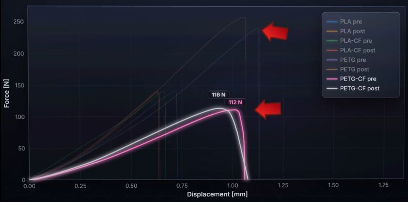

For the sample materials PETG and PETG-CF, as well as PLA and PLA-CF filaments are used, with each filament type featuring an annealed and not annealed version. These were then tested for tensile strength, stiffness and failure type, as well as dimensional accuracy and warping, before being examined under the SEM. A total of 160 samples were used, with 20 samples per material and annealing state.
Perhaps the biggest surprise here was how much PETG benefits from annealing, making it much more resilient to breaking, whereas neither PLA nor PLA-CF seemed to see much benefit. Shocking was how much worse PETG-CF performs than PETG, with the former being worse than both PLA and PLA-CF here.
In terms of dimensional accuracy, annealing caused a Z direction expansion while shrinking the samples in the  other directions. The CCF addition here actually prevented much of the shrinking and expansion, showing the first clear benefit of this additive. Yet despite annealing at right above the glass transition temperature as is proper, this would seem to be the limit of this approach in terms of practical benefits.

  1. just gonna point out again that these are all the same numbers. the smallest number is 321 N and the largest is 542 N. those two numbers are identical. if you throw out the garbage CF filaments, the smallest is 454 N, which is even more identical to 542 N.
    focusing on this sort of strength-of-filament metric is not a meaningful way to improve your prints in real life. for example, the difference between new PLA and year-old PLA is much larger than any of the differences measured here. there are things that really matter for your prints, but this ain’t it.
    just trying to discourage from people filament shopping for strength. if your designs are failing for lack of strength, there are many much more effective things you can try than shopping for a new filament.
