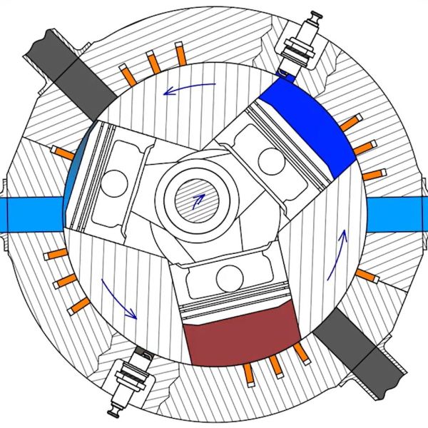

The claimed benefits of this design include a small size, low vibrations, reduced gyroscopic effect due to counter-rotation, no apex seals, and less mechanically complex than a piston engine. This comes at the cost of a very short stroke length and thus the need for a relatively high RPM and slow transition between power output levels, but those disadvantages are why small airplanes and UAVs are being targeted.

  1. It may have its uses, but some critique from just the drawing at the top:
    Short connecting rods means large friction between piston and cylinder.
    Friction between rotating cylinder block and casing.
    Large areas for heat transfer between fluid chamber and casing.
    And was the sealing issues inherited from wankels ever solved?
    Yes, I find all the many alternative engines I have seen over the decades interesting, but they all eventually fall short of ‘pistons and poppets’.
    Absolutely try other cycles (fex atkinson or miller), opposing pistons and ancillary systems. But the basic engine design comes back to the same.
  2. He didn’t say a word about lubrication; the crankshaft and piston seals could use regular oil, like a four-stroke, but it seems the seals for the rotating part would require oil mixed into the fuel, like a two-stroke engine, with an the nasty emissions that causes. It would only be fair to compare it to other two-stroke engines, instead of the four-stroke 912, and I think those would get a significantly better power to weight ratio.
    Also, the fuel efficiency isn’t just about internal friction, the short stroke and limited angle for the power stroke would probably make this engine less fuel efficient than the competition.
    1. I would assume that any oil lubricating the crankshaft would be pooling up on the pistons and leak out through the piston rings as it gets spun around at a couple thousand RPM. It’s difficult to see how you even get oil flowing in and out of the crankcase. Some must go in, otherwise the whole thing would seize up, but how it comes out of a rotating part and back into the loop without leaking everywhere… maybe it is actually just dripping oil into the crank very slowly and allowing it to leak out through the piston rings.
      The second issue is cooling. The rotating cylinder block cannot have water channels in it because again, how do you pump coolant in and out without having it leak everywhere? Since it’s rotating it cannot have a large surface area in contact with anything else, so it seems like the engine would simply overheat under load.
      1. the rotating part could have oil seals on the faces or the outside circumference, just like crankshaft etc. have. Another issue is uneven heating and thus distortion, because like in a wankel the intake and combustion always happen in different places
        1. There’s no perfect moving seal, so oil would end up in the combustion chamber, and fuel and exhaust particles would end up in the oil. To keep the oil from fouling and re-circulating soot into the engine, it makes sense it would simply leak the oil and let the engine burn it at a controlled rate.
          1. no different than a regular piston engine, oil control rings are not perfect but pretty good, oil consumption is bad for emmisions

  4. I believe this engine would be a great setup for a hybrid vehicle. I know Mazda is currently working on a rotary engine hybrid. You could run this engine at its most efficient RPM and only use this engine to run a generator to charge the batteries not to “drive” the car.
    1. Was going to say the exact same thing. Pair this with a Plug in Hybrid version, kinda like the Volt. That the engine is efficient only at a specific RPM wouldn’t be a problem as power generation can be tailored for that.

      1. I’m saying straight up that the summary that it’s halfway between a piston engine and a wenkel engine is wrong but that gee a summary would have been appreciated
  6. Light weight revvy engine requires heavy gearbox to work with real word propellers…
    Also: Airplane engines are mostly built to be reliable.
    The engine having counterrotating masses is pointless.
    If you have a gearbox, you turn the prop the opposite direction from the engine rotating assembly.

  9. I would like to supplement some prior art information about this birotary engine layout.
    I am Zhang Hao, the inventor of Chinese Patent CN93107565.3, filed in 1993.
    The core structure includes a stationary cylinder head, three cylinders radially arranged at 120° around the crankshaft, the same four-stroke working principle. The Knob design only reverses the rotation direction of the cylinder block on this original architecture.
    Knob claims he conceived the idea in 1988, yet no published papers or patent records can be found before 1993, and his first formal patent application was submitted in 2012. My complete design was publicly published in Issue 6 of the Chinese professional magazine Motorcycle in 1995.
    I only intend to record the complete technical history objectively, and I can provide verified documents if needed.
    https://zhuanlan.zhihu.com/p/2062656723849049400?share_code=1oxFAWpLPMUN4&utm_psn=2063020425479825135
  10. Optimized Design Concept for a Four-Stroke Engine with Rotating Cylinder Block
    Optimization of my four-stroke rotating cylinder block engine patent CN93107565.3 filed in 1993
    1. Standard off-the-shelf pistons and piston rings available on the market can be adopted directly, eliminating the need for custom special-shaped seals. It enjoys a mature parts supply chain and excellent versatility for maintenance.
    A cylindrical seal is arranged between the stationary cylinder head and the rotating cylinder block, which is easier to manufacture. To reduce wear on the sealing rings and improve overall efficiency, a transmission ratio of 5:1 can be set between the crankshaft and the cylinder block. Correspondingly, twin spark plugs, dual intake ports and dual exhaust ports are fitted on the fixed cylinder head, enabling two power strokes per full rotation of the cylinder block. The load can be coupled to the crankshaft for high-speed operation, or connected to the rotating cylinder block for low-speed high-torque output.
    The Czech developer KNOB has developed fully functional flight-capable prototypes built on the exact same core working principle, with only one modification: the reverse rotational layout between the cylinder block and the crankshaft.
    2. The three cylinders are arranged radially and symmetrically at 120° around the crankshaft. Their inherent inertial forces counteract one another, delivering superior dynamic balance and allowing for a simplified flywheel design.
    3. A cylindrical sliding valve intake structure is adopted. This

  14. When the relative transmission ratio is identical, the linear speed of the sealing components surges sharply. For instance, if the relative transmission ratio is 2:1, the co‑rotating transmission ratio shall be 3:1 while the counter‑rotating transmission ratio is 1:1; if the relative transmission ratio is 4:1, the co‑rotating transmission ratio shall be 5:1 and the counter‑rotating transmission ratio is 3:1.
  15. For the birotary‑cylinder‑block engine configuration, the relative sliding speed of the sealing pair is a key factor determining service life.
    Under the operating condition of two power strokes per full revolution of the cylinder block, the theoretical transmission ratio is 5:1 for the co‑rotating design of my patent CN93107565.3, and 3:1 for the counter‑rotating layout.
    Compared with the co‑rotating solution, counter‑rotation results in a substantially higher linear speed of the sealing rings, heavier wear and a shorter maintenance interval.
