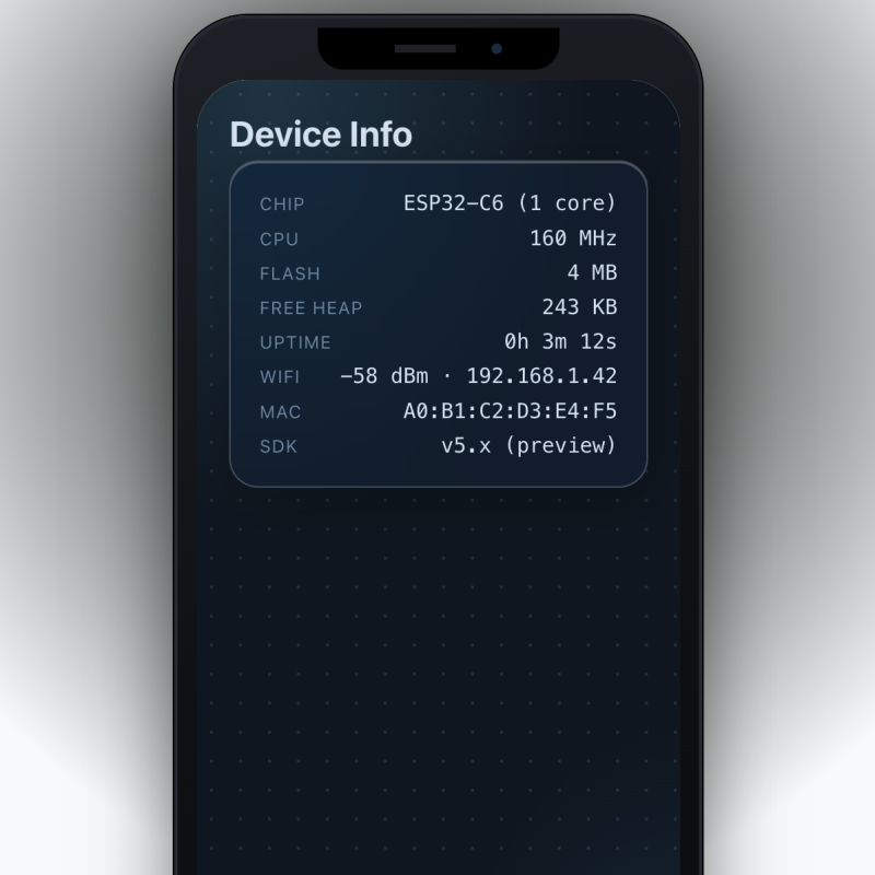

These days, a lot of embedded projects feature some sort of screen, and a screen often creates a desire for a nice user interface. [Geoffrey Wells] has created a tool for developing web interfaces for the ESP32, named ESP-GenUI.
The aim was to make UI development as easy as possible for this platform. ESP-GenUI allows the creation of a website by dragging various nodes on to a canvas and linking them up to create the desired web interface. There are nodes for GPIO control, camera feeds, gauges, and all sorts of other common elements for quickly putting together dashboards and control panels. All this is done from within the browser, and the code generated by the tool can even be flashed without having to open any external tools. Alternatively, it can spit out Arduino code that you can open and flash from within the IDE. You can try the tool out yourself right here.

    “Graphical design tools suck / LabVIEW”, this isn’t that. It’s a code generator, not a runtime. You diagram the UI layout, hit Generate, and get a normal Arduino sketch or ESP-IDF project — plain C/C++ you own and open in your own editor, compile with idf.py or IDE. There’s no wires-as-logic execution model
    to get trapped in; the diagram just builds the tedious part (route handlers, HTML strings,
    CSS). If you hate the app tomorrow you keep the code and never open it again.
    “Just hand-roll HTML and compile it into the webserver” — that’s exactly the output. No framework, no runtime on the device: plain HTML/CSS baked into the firmware as strings, served by the webserver. On bloat/fonts specifically — the generated pages use the system monospace stack and inline CSS, so zero web fonts, zero CDN, no internet dependency on the chip. You’d write the same thing by hand — among other things, this just skips the monotony of escaping quotes inside PROGMEM string literals.
    “Not open source / vibecoded SaaS” — correct, the tool is commercial with a free tier, no card required. Legit reason to pass and I won’t argue taste. But the thing you take away is unencumbered: the generated project has no dependency on the app, no license phone-home, no runtime lock-in — download it and keep editing offline. As for “vibecoded,” the bar it’s held to is that the generated IDF/Arduino projects compile clean and boot on real silicon, which they’re tested to do. — even closed, a decent idea can seed the open version. I’d be fine with that.
