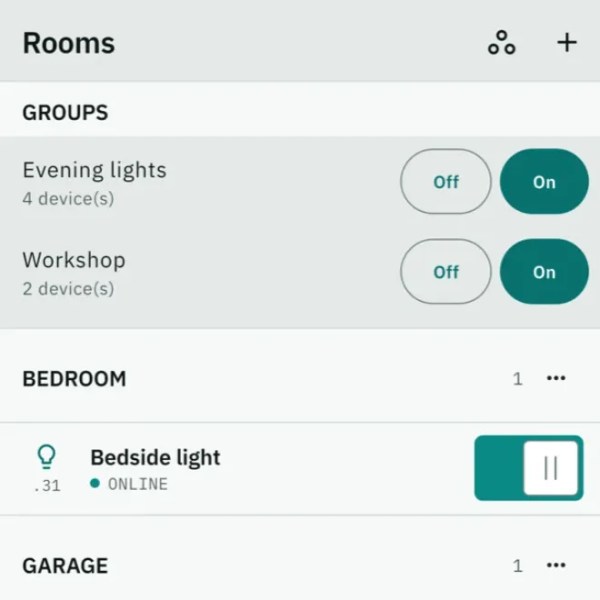

The Tasmota firmware is a popular choice for flashing to a range of Espressif microcontrollers to turn them into smart home devices. If you have such devices in your house, you might wish they were easier to integrate with the Apple Home platform. As it turns out, though, there’s a convenient app for that.
[Christof Müller] built an app called Tasmoshelf for just this purpose. Its primary claim to fame is that it can easily help port a Tasmota-based setup into the Apple Home universe. It can achieve this without requiring a Home Assistant server or MQTT broker or any other workarounds. This is thanks to the fact that Apple Home is compatible with Matter technology, as are ESP32 devices running Tasmota 13 firmware or newer. They can natively jump on an Apple Home setup, and even act as a bridge for older ESP8266 devices that can’t speak Matter themselves. The device is able to run network scans to automatically discover devices and advise whether they can hook up directly to Apple Home, or whether a bridge is needed.
If you’re running Tasmota devices and want to easily integrate them, you might find Tasmoshelf a useful addition to your smart home setup. Just note that it does require a one-off purchase if you intend to use it beyond three devices, a limit which some might find somewhat restrictive.
