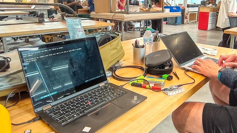

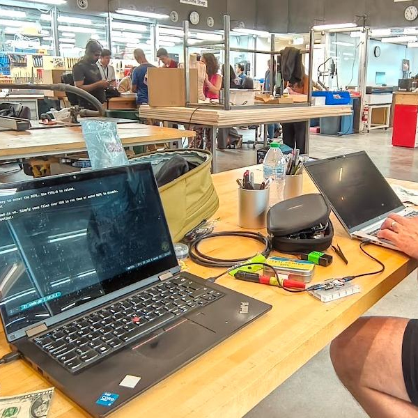

It’s likely many of us have been in the position of first set-up on a machine such as a Raspberry Pi, and had keyboard problems. Either no spare keyboard is to be found, or a cluttered desk has to find extra space for a full-size keyboard. [Þórarinn] and [Arni] have a handy solution: use the existing keyboard on your laptop.
His approach is both ingenious and simple, as it’s only the K part of a KVM. On the laptop end, it’s a serial terminal, without the receiving side. The serial port in question is an RP2040 board which implements a USB-to-serial port. This serial connection goes to another RP2040, which does the ingenious bit. It’s a serial-to-USB HID keyboard. All of this means that keystrokes on the laptop are sent down the serial connection, and appear on the Pi or whatever computer as a USB keyboard as though typed locally. The mildly annoying first set-up can be done, and then it can be run via SSH or whatever other remote access protocol as normal. The code is provided, so anyone with a couple of RP2040 boards can do it.

  5. CH9329 is an existing chip (readily available as a breakout board with USB connector) that does this exact function, supporting keyboard, mouse, and absolute pointer HID endpoints, with the reports sent to the chip over UART. For an example of a client for this chip, see https://github.com/sjmf/kvm-serial
    I piggy-backed an ESP32 mini onto a CH9329, connected the 5V, RX, TX and ground nets, and can just plug the result in to a target computer and start “typing” on it.
    Total cost: about $4-5.
    1. One thing to note is that using a plain old serial terminal does limit the keys that can be sent. For example, Alt-F4 will kill your terminal program, and Ctrl-Alt-Del and other such keys will also not be available.
      For this reason, I much prefer to have the receiving end implement a VNC server, which means you can use any VNC client to interact with it, and benefit from programs which are designed to be able to send “impossible” key combinations.
      It’s always an option to proxy a TCP socket to UART using socat or similar, while the VNC absolute pointer coordinates map well to an absolute pointer endpoint in the CH9329. Trying to map absolute coordinates to relative movements when you don’t know the resolution of the target screen can be an exercise in frustration.
