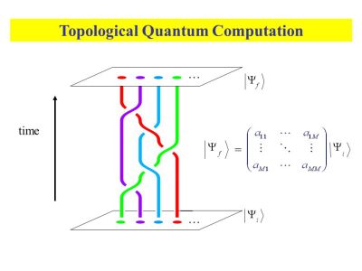

In traditional quantum computing generally Dirac fermions are used as the qubits for quantum computations, but so far this approach has been fraught with complications and challenges, with decoherence and noise intrusion making long-running computations extremely hard and necessitating the need to run computations multiple times for error-correction algorithms to have a shot at divining a plausible result.
This is where topological quantum computing comes into play, as although it imposes some limitations on its feature set, it would be much more resilient to outside influences. Some confusion here may exist with the referencing of Majorana particles, as fermions come in Dirac, Majorana and Weyl flavors. What is referenced here is actually a Majorana anyon, a quasiparticle that just happens to have the same property as Majorana fermions of being its own antiparticle.
By combining these anyons with braid theory using the intertwining of the anyon world lines it becomes possible to perform operations, which theoretically can be used to create a topological quantum computer.
Essentially, this swaps the very fickle, trapped quantum particles for significantly more stable braided Majorana anyons, which – if confirmed – could herald a significant breakthrough in the world of quantum computing.

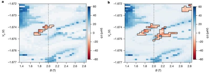

Consequently, Legg’s most recent critique comes as response to Microsoft Azure Quantum’s paper in Nature which got published as a result of that new approach. In this paper it’s claimed that this time they really did detect topological qubits in this improved test setup with TGP, based on – again – indirect measurements and analysis of recorded data. In Legg’s critique it is this analysis of the measurements that’s being attacked as having been performed incorrectly.
The main issue that he identifies is a selective interpretation of the measurements, focusing on the data that supports the experiment’s assumptions, in what would essentially be confirmation bias. There’s also the argument that Microsoft’s researchers made a number of mistakes in their Python code, where they use the array index rather than its value. After adjusting for said basic Python errors, Legg then got entirely different results based on the same measurements.
Impact of coding artefacts on transport based topological gap detection (Credit: Legg, Nature, 2026)
As noted by Legg, you can get very similar data signatures from sources like quantum dots. Along with the somewhat fundamental data processing issues, this obviously puts into question just how close the Microsoft team was to actually having created these topological qubits.

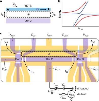

Model of Microsoft's system, example energy spectra and the gate layout for the interference loop. (Credit: Microsoft Azure Quantum)
Model of Microsoft’s system, example energy spectra and the gate layout for the interference loop. (Credit: Microsoft Azure Quantum)
Of course, Microsoft’s team got in their reply (paywalled) after taking that broadside salvo. Their main arguments seem to be that TGP has no role in interpreting the RF results – being just a tune-up procedure – that form the basis of the original conclusions, nor do they recognize the issues with TGP that Legg indicated as being valid.
Another point is that Legg offers no alternative physical model that is capable of reproducing the capacitance signal or the RTS phenomenology, and thus the response basically seems to boil down to a curt ‘nuh uh’.
They did acknowledge an off-by-one pixel bug in the TGP processing, but insist that it is only a minor issue.
Effectively, the criticism is rejected, with the original 2025 paper maintained as being valid. This would mean that these topological qubits were truly detected, and with this knowledge a functional topological quantum processor could be constructed and integrated into a larger system.
