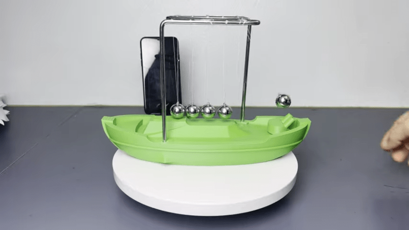

If any astute Hackaday reader saw [dongvua90]’s Newton’s cradle go on without human intervention all day long, they’d probably suspect the truth: there’s a battery and a magnet involved. But it is a nice desk piece, and you might be able to fool your less enlightened friends that you’ve discovered perpetual motion. Watch the resulting faux perpetual motion machine in action in the video below.

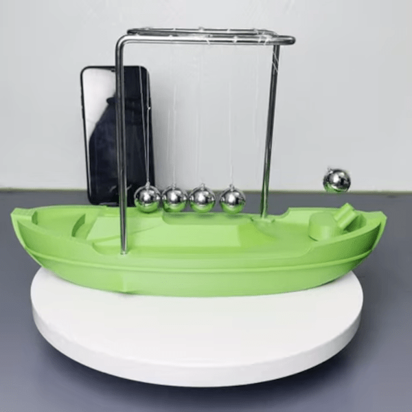

The trick is to sense the ball’s travel and inject a little electromagnetic pulse at just the right time. No problem for an ESP32 and a proximity sensor like the ones you find on some 3D printers. In fact, there’s very little custom circuitry. Everything is a module, and even the Newton’s cradle is cut out of a premade toy. A printed case and some software are really the heart of the design.

        Triggering it only requires a large enough change in the magnetic field through the coil. That means you can put the permanent magnet in the coil, and some ferrous metal moving past will trigger the circuit – like how a guitar pickup works.
        The swinging steel ball is attracted to the magnet both ways in and out, giving you net zero energy gain. But, if the circuit is triggered when the ball is swinging away from the magnet, the coil cancels the permanent magnet briefly and lets the ball escape with more energy.

  1. Why use a separate sensor? When the steel ball passes over the electromagnet, it creates a pulse in the electromagnet’s coil that can be used to fire the next pulse to the coil. All that’s needed is a delay circuit that is triggered by the ball’s passing, and discharges a capacitor to yank the ball. No microcomputer needed., though an additional magnet might be needed under the coil to increase the initial pulse.

  3. Hi everyone, I’m the creator of this project.
    I just wanted to clarify a few things. Yes, the YouTube thumbnail was AI-generated. The project itself is completely real—I designed and built it myself. I used an AI thumbnail because a normal photo of the finished Newton’s cradle looks just like any other one, and I wanted to hint that it contains hidden electronics. I didn’t realize it could make the project seem fake. Thanks for pointing that out—I won’t do that again.
    I’m also from Vietnam. My channel is in English because I want to share my projects with an international audience, and I use AI voice narration because my spoken English isn’t good enough yet.
    As for the AliExpress links on Instructables, that was my first post there. I don’t normally buy my parts from AliExpress—I just linked to similar components so people could find them more easily. They are not affiliate links, and I don’t earn any commission from them.
    Thanks for the feedback, and I’m happy to answer any technical questions about the project.
