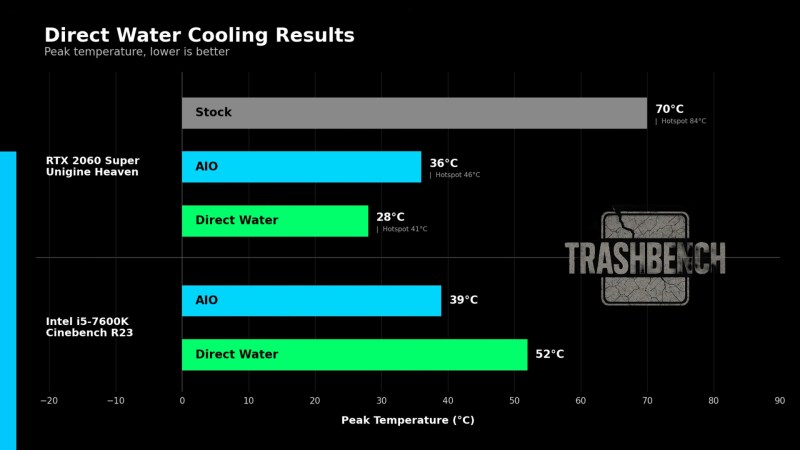

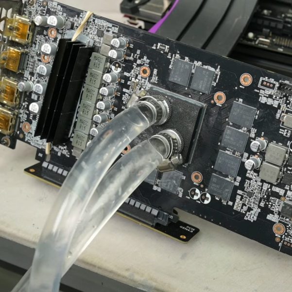

If you’re water cooling a PC, it’s generally accepted that you need some interface between the coolant and the chips — a water block of copper or aluminum that carries the heat-removing fluid. What if you just…didn’t? That’s what [TrashBench] asked with his direct water cooling experiment. Instead of integrated pump or copper water block, he just epoxied a 3D printed pipe fitting onto his bare GPU and CPU.
The results are interesting: while the directly-cooled GPU outperforms the professional system by a decent margin, the same technique fails when applied to the CPU. It also leaks and nearly ruins his hardware, but those are the risks you take when doing mad science, and it’s nothing more epoxy can’t fix. In any case, the fact that directly exposing chips to liquid can cool them down isn’t exactly a revelation. People have been dunking computers in oil for years, but the fact that he sees such a difference between CPU and GPU is quite interesting. [TrashBench] has his own theory in the video, but what do you think is going on here?

  2. Not entirely shocking results, the RTX 2060 has a large die with low specific heat output.
    The Intel chip has a small die with highly concentrated heat output. You need surface area to transfer the heat to the water
    Another reason it can be easier to cool a chiplet design as you get a spread of heat that is easier to transfer.

  6. Focusing all your attention on the silicon die is pretty small thinking when it comes to a topic like this. For example, I have a GTX 1080 Ti that will overheat, puke up artifacts, and then crash, if you change nothing except removing the backplate. (I bought it cheap because it was missing the original backplate and was sold as ‘works, but overheats/crashes’)
    I found a spare used backplate. It’s aluminum and has some (minor, mostly decorative) texturing, and the working thickness is about 1.5mm of thermal pad plus another 1.5mm of aluminum. Under full load with the board pulling 250W+ the GPU core runs at 60C, while a thermistor stuck to the backplate runs at 57C. All that heat load going into the backplate is coming through the PCB! There are no significant heat sources on the back of the card. And yes, all that heat into the backplate is with proper thermal pads on the front of the card directly coupling the IC packages to the cooler.
    1. But if you can get a heat transfer fluid that can take all the heat at the rate desired, your example would be just adding layers of mass and thermal resistance between them.
      1. How’d you get that from what I wrote? My point was, a nontrivial amount of the necessary cooling is for components that are not the silicon die of the GPU core. And also that just monitoring the GPU internal die temp won’t tell you much of anything about if the card is being cooled properly.

  12. There are a lot of different hot spots on a GPU beyond the core (memory, VRMs, etc). They are normally handled with some thermal contact with the main heatsink. I wonder what happens to them in this setup. But I don’t wonder enough to watch the video.
