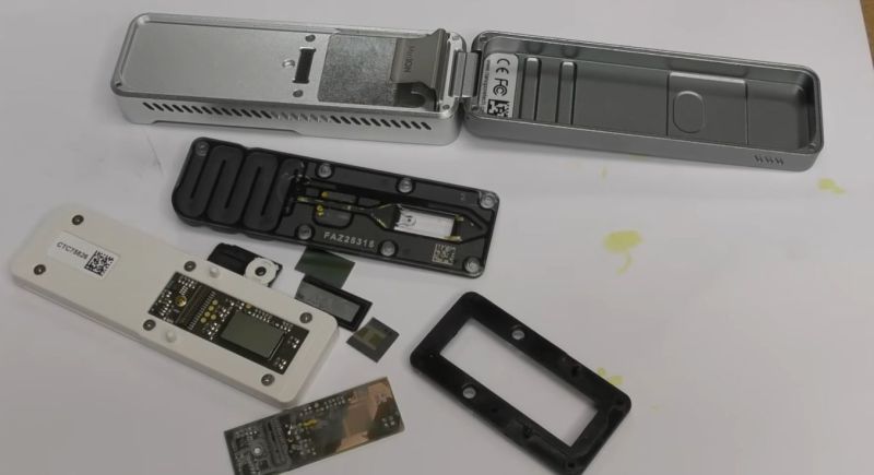

For most people the term ‘DNA sequencing’ probably brings to mind large, expensive laboratory equipment in sterile rooms, but over the past decades technological progress really has had its way with it, to the point where it’s now just another small portable device. Something like the Oxford Nanopore MinION unit that [Mike] recently took to bits to ogle at the intricate insides.
This device was trialed in 2014 in a limited release before its commercial release in 2015, with this paper by [Miten Jain] et al. in Genome Biology detailing the workings of this nanopore sequencer. At a mere $2,000 it’s rather remarkable how affordable it is, though this comes with the caveat of the consumables, which are also shown in the video. These come in at a cool £690 per unit, can sequence either RNA or DNA and can be used at most a few times before they need to be replaced.

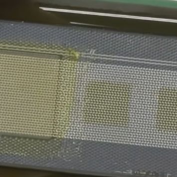

The main unit is fairly simple, featuring a Xilinx Spartan 6 FPGA and a rather nice slim fan-based cooling solution. For the nanopore unit you get the typical microfluidics system, to guide the deposited fluid containing the genetic material to sequence over the nanopore system. In here we see the actual magic as well, in the form of the high-density pitch ICs on both sides of the PCB inside the consumable sequencer unit.
Although this particular unit got discontinued already, the consumables are still available for it if you are feeling the sequencing itch. Of course, we’re likely to see the costs for DNA and RNA sequencing to keep plummeting, as what were once complex chips get overtaken once again by the progress of technology.

  3. That is really intriguing, and the consumable actually looks like something the crazy home fab folks might be able to do – unless i missed something it seems like the features are actually relatively large.
    1. the issue is organic micropores are extremely hard to produce and not destroy. not impossible, but the chips essentially have to stay wet or the pores die off. that leads to all sorts of challenges afterwards. not to mention the micro impedance they are measuring to determine which atc or g is coming through. really cool tech for insanely low price. the larger versions have been able to sequence an entire genome in 4 hours! I love how the future is finally here.
  4. Fantastically cool. I’m always looking for ways to incorporate this in my actual work, but they have the downside of high per-base error rates (so you need a ton of depth to compensate). This downside is offset by the huge read lengths it can generate, some as long as whole genomes, depending on the organism.
    In terms of re-using these, the flow-cells are where to cost is, and those take a protein complex to work. I would be so excited to see someone home brewing that.
