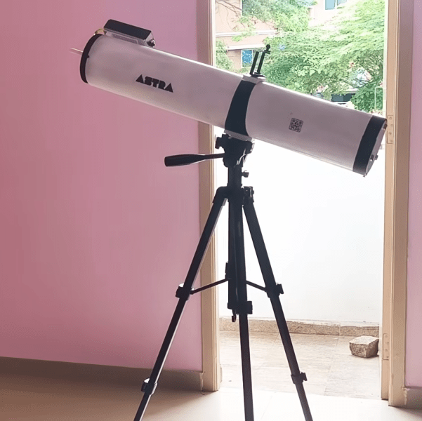

[Makestreme] had always wanted to own a nice telescope, but found that budget would not stretch to anything above a cheap model with a limited 50 mm aperture. Wanting a better view of the heavens, the way forward was obvious—it was time to build a better telescope, instead!
The build is based around a 114 mm diameter mirror sourced from Amazon. It’s assembled inside a length of 5-inch PVC pipe of just under a meter to suit the 900 mm focal length of the concave reflector. 3D printed components are used to mount the mirror and control its position for proper focus and collimation. Traditionally, a reflector based telescope would use a mirror and eyepiece to provide a view to the user. However, [Makestreme] built this as a smart telescope, instead integrating a Raspberry Pi Camera Module 3 at the focal point. It’s connected to a Raspberry Pi Zero 2W, running off an 18650 lithium-ion cell and a 5 V boost module for portability. The Pi runs a Python script that hosts a small web server allowing access to the live camera feed along with controls for brightness, exposure, and gain. [Makestreme] then uses apps like SkyMap and SkEye to help aim the telescope at astronomical elements of interest.

      Nowhere in this ‘hack’ is mentioned THE omnipresent flaw with a Newtonian telescope: “Central Obstruction”, and how much of a problem this is, with this design It appears, from the photographs, that central obstruction is a big problem here. This, alone, would account for the poor pictures obtained, and which are, instead, written off to bad weather, etc.
      In order to build a good telescope, one has to understand the very basics of telescope design; telescope basic design cannot be improved upon simply by using the latest available electronic devices and coding techniques.

  4. One of the reasons for the poor images is that you need an IR/UV cut filter because the digital camera is sensitive to the invisible wavelengths. Also the double sided foam tape is a very poor choice for mounting the mirror to the mirror mount. The foam will insulate part of the mirror and won’t allow the glass to come to an equal temperature to the outside environment. This causes the mirrors figure to not to focus all at the same place and the insulating properties of the foam tape exacerbates this. Remove the tape. Use small dollops (about 5mm) of silicone glue (one per each leg of the mount at 60% of the radius of the mirror back) and use a small coin about the size of an American Dime to temporarily suspend the mirror above the mount. The silicone glue is more than strong enough to hold the weight of the mirror. When the silicone dries, remove the coins from between the back of the mirror and the mirror mount.
    Do the above and allow your telescope mirror to equalize to the ambient temperature of the outside air for about an hour or at least 30 minutes. The mirror needs to quit expanding or contracting before it can focus properly.

  7. I tried this project but the Focus was a nightmare and the quality image was crap.
    Now im triying with a bigger mirror and better sensor since there are better sony imx sensors compatible with Raspberry than the one used here (starvis2).
    But for me the Focus mechanism and the mirror área and shadow área ratio has to be improved since the sensor mount block to much and im sure you cant avoid bad alignements with this setup
