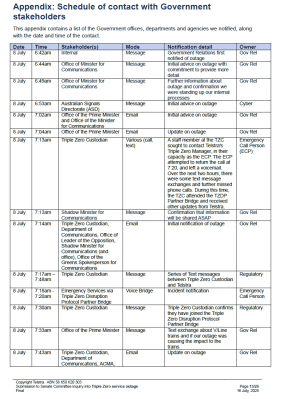

The issue was first detected at 4:20 AM. The naughty server was isolated by 7:11 AM, but it would take until 10:30 AM to identify all the network components which had received erroneous time data. It took several hours further—until 4 PM—to properly quell the NTP issues. In the meantime, a significant portion of the country had seen its phones offline all day, and entire rail networks had ground to a halt as their Telstra-based communications systems went completely offline.

In the case of this outage, camp-on functionality worked—some 3,200 Triple Zero calls were passed to Optus and TPG networks when Telstra’s failed. However, there were some ongoing issues that saw a further 604 Triple Zero calls fail over the period to 2 PM the next day.

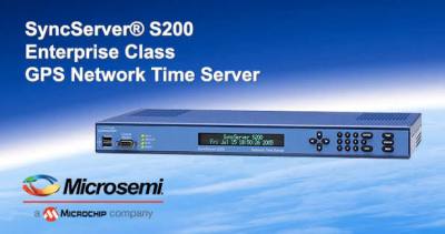

Small correction- the device referenced in the article is the SSU-2000 (see https://www.microchip.com/en-us/products/clock-and-timing/systems/telecommunication-clock-systems/ssu-2000 ), not the Syncserver S200 shown in the adjacent picture (the SSU-2000 is a different form factor and doesn’t have a display).
